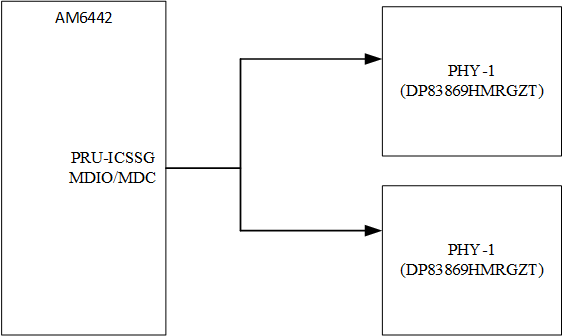

Can we share the MDIO signals from PRU-ICSSG-1 for 2 same PHY's
Thanks and Regards,

    Can you please provide some more details on the usecase? When you say 2 same PHYs, I am assuming that you are using 2 separate PHYs of same model number, but with different PHY addresses. Please correct me if I am wrong.
    Out of the box, we can use same MDIO instance to configure the 2 PHYs of given ICSSG instance. But if you are planning to use two separate instances of ICSSG, each controlling one PHY, then you need to use two MDIO/MDC instances.
    Teja.
  • Hi Teja,
    we are using two PHY's (PHY1 AND PHY2) of same part number
    Rubigaa
  • Hi Rubigaa,
    That should not be a problem. You can use same MDIO/MDC instance to communicate with the two PHYs connected to same instance of ICSSG irrespective of the PHY part number.
