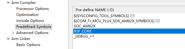

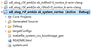

I imported the example from C:\ti\mcu_plus_sdk_am62x_10_01_00_33\examples\sdl\stog_r5f\am62x-sk\system_nortos\
Then, I compiled the M4F and R5 projects and copied the generated appimage.hs_fs into the below path.
--file=sbl_prebuilt/am62x-sk/WZ_Debug/sdl_stog_r5f_am62x-sk_r5fss0-0_nortos_ti-arm-clang.appimage.hs_fs --operation=flash --flash-offset=0xA00000
--file=sbl_prebuilt/am62x-sk/WZ_Debug/sdl_stog_r5f_am62x-sk_m4fss0-0_nortos_ti-arm-clang.appimage.hs_fs --operation=flash --flash-offset=0x100000
I use the file below to flash the test examples
4011.default_sbl_ospi_hs_fs.cfg
Below is the UART log from SBL UART
There is no uart log can get from R5 or M4F uart

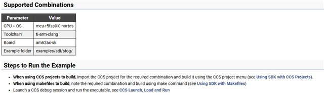

Question: How to make this system stog example run?
