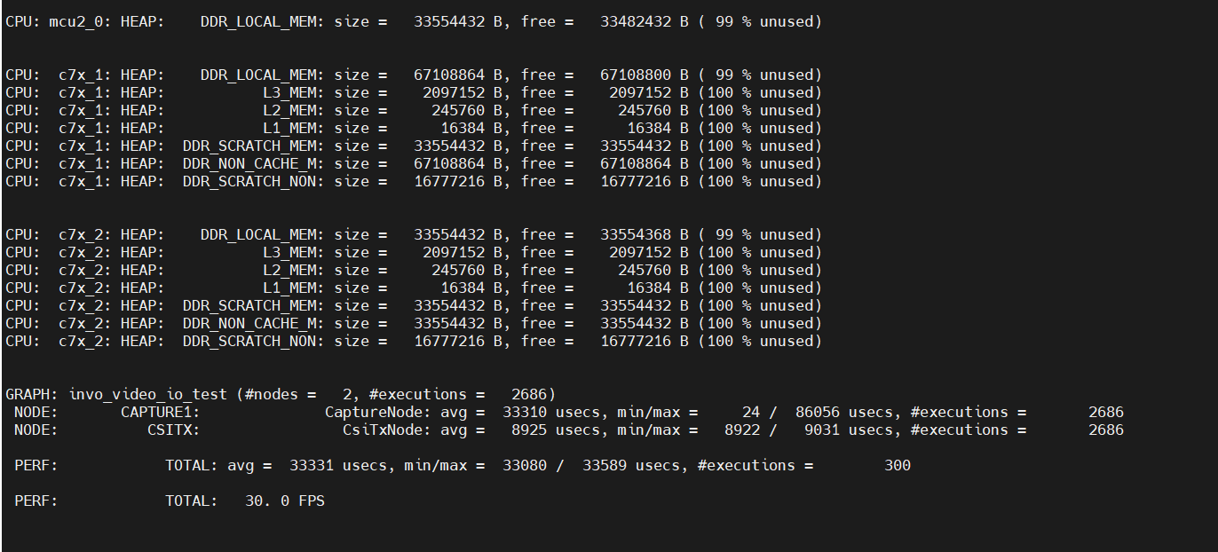

We have established such image data link:
camera -> serdes ->  capture  -> csi-tx -> serializer(max96717)  -> image adapter plate
When running, the graph is 30fps as below.
However, the serializer at the back end of the csi-tx module shows that no data has been received.
I measured that there were valid waveforms on both MIPI data lane and clock lane.
Finally, I discovered that by performing a soft reset of the csi-tx (0x30181020) twice, the serializer showed that it had received the data.
However, we have never encountered such a problem on the j721e and j721s2 before.
Could you help me figure out why there is such a difference?
