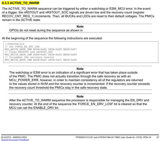

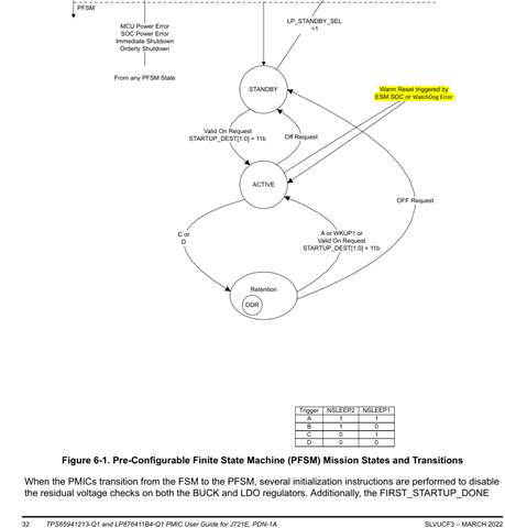

    Typically, an SoC Cold Reset can be accomplished by asserting both MCU_PORz and PORz inputs low which occurs during a normal power-up sequence.  These SoC inputs are connected to the PMIC's nRSTOUT and GPIO_10 outputs with NRSTOUT_SOC function assigned to GPIO10 by the PMIC's NVM settings, as shown in PDN block diagram below.
    Section 8.3.8 in the PMIC's datasheet clarifies nRSTOUT & nRSTOUT_SOC function assigned to a GPIO are associated with the NRSTOUT and NRSTOUT_SOC bits within the PMIC control registers.  SW running on the MCU can assert the NRSTOUT_SOC bit to execute a cold reset of the SoC's main processing domain only.

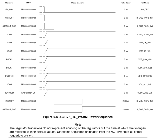

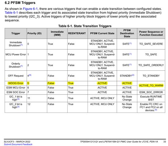

    If you desire to reset both MCU & Main processing domains, then the PMIC's Pre-configurable Finite State Machine (PFSM) must execute a Warm Reset as shown in Fig 6-1 of the J721E PDN-1A PMIC User's Guide (snap-shot below). The system SW can overwrite the WDOG Timer value to force a PMIC Watchdog error resulting in the PMIC executing the desired Warm Reset state transitions.

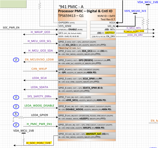

    I guess you mean GPIO11 here, at least that is what all diagrams are depicting.

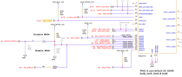

    This is our schematic of relevant parts of PMIC-A:
    Please note that we have an additional MCU in our setup. There is an STM32 acting as power supervisor and main controller of power up/down. In essence, the MCU_PORz signal is directly connected to said STM32, which deassert and assert it as the user presses the reset button.
    Is this a faulty setup? In your description above it seems that a correct reset of the whole SoC should be initiated by the watchdog and not by directly acting upon the MCU_PORz signal. The watchdog would then result in BOTH MCU_PORz and SOC_PORz, which would in turn lead to a full reset.
    Can you comment or advise on this?
    /Bo

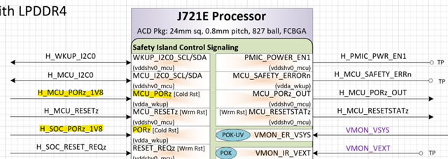

  • Using an independent MCU is a valid approach. In fact, asserting MCU_PORz will reset both the MCU & Main processing domains as described in the DM.
    I had suggested the Wdog timer approach in case you did not have an independent MCU and wanted to assert both PORz signals concurrently.
