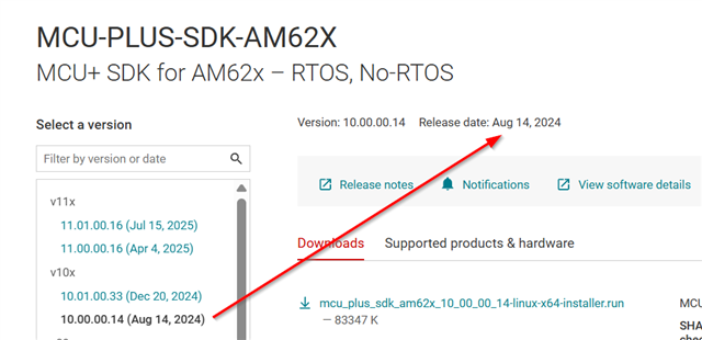

MCU SDK 10. 0.0.14 released on Aug 14.2025

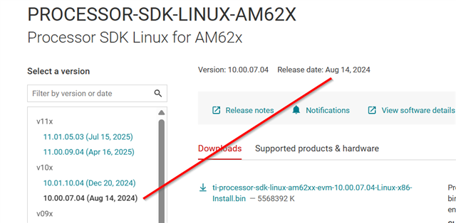

Linux SDK10.0.07.04 release on the same day Aug. 14.2025, but its ti-firmware mc sdk version is 10.0.0.8, not 10.0.0.14.
Now customer need to modify something base on MCU SDK 10.0.08.
Find source code from here, follow the README.md,
https://github.com/TexasInstruments/mcupsdk-core-k3/blob/REL.MCUSDK.K3.10.00.00.08/README.md
get error on repo sync
