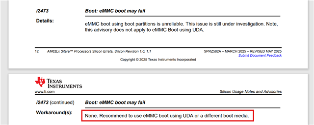

    As noted from <Table 1-2. Advisories Matrix> in AM62L Errata https://www.ti.com/lit/pdf/sprz582, there're eMMC boot issues from eMMC boot partition in AM62L PG1.0 ROM, and your test struck the eMMC boot issues.
    -Hong

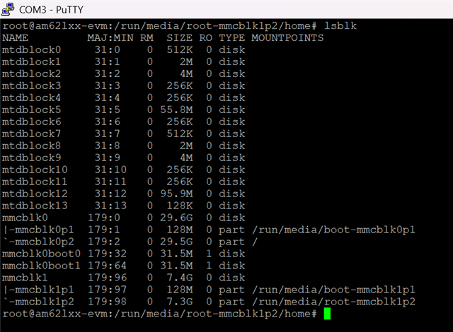

  • Hi Hong,
    As you suggest BOOTMODE[15:12] = 1010 => Fixed 3 => MMC/UDA (primary) UART (backup) and also given in Errata like to use eMMC UDA mode.
    I put board with this pin mode in MMC/UDA (primary) UART (backup) (0-15: 00000000 0000 0101) without SD card, I can't see any log on UART console.
    But when I put SD card in same pins configurations, Board is booting from eMMC. Here I also attach image of it.

  • Hi Parv,
    With AM62L PG1.1 fixes on ROM as noted in <Table 1-2. Advisories Matrix> in AM62L Errata https://www.ti.com/lit/pdf/sprz582, I'd recommend re-run your test on AM62L PG1.1 silicon.
    -Hong

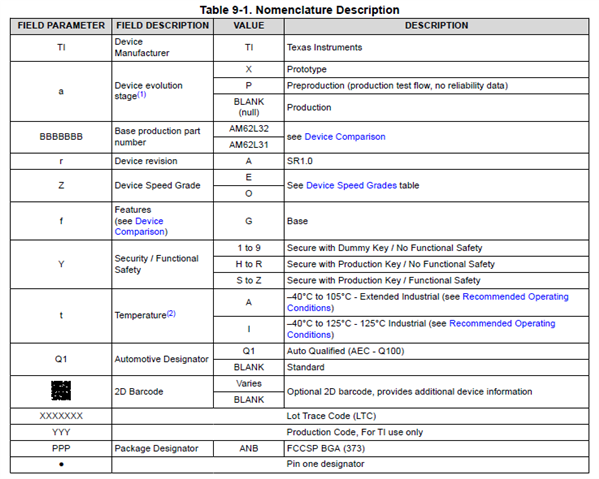

  • Hii,
    Can you please give me part number of SR1.1 silicon?
    My EVK with SR1.0's part number is XAM62L32AOGHAANB.
    Parv
  • Hi Parv,
    In reference to <Table 9-1. Nomenclature Description> in AM62L datasheet https://www.ti.com/lit/ds/symlink/am62l.pdf, The <Device revision> field increments from "A" to "B" for SR 1.1 silicon.
    Please work with TI local team on on how to order AM62L SR 1.1 silicon.
