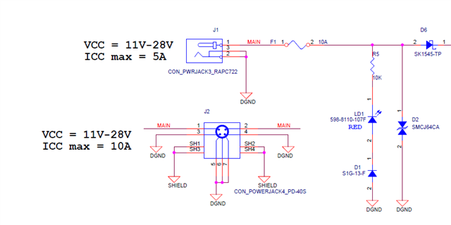

We are evaluating the TMDX654IDKEVM (AM65x/DRA80xM Industrial Development Kit, Rev. B) and need to clarify the power input connector.
The board supports power through a 4-pin DIN jack (J2). Since TI’s AC adapter is not included in Japan due to PSE marking requirements, our customer is selecting a third-party AC adapter.
However, there are multiple 4-pin DIN types in the market (for example, some use pins 1 & 2 as +V, others use pins 2 & 4 as +V). To ensure correct adapter selection, could you please confirm the exact pin assignment (voltage pin mapping) of the 4-pin DIN connector (J2) on the TMDX654IDKEVM?
Additionally, if there is a schematic excerpt or official documentation that describes this assignment, could you kindly point us to it?
