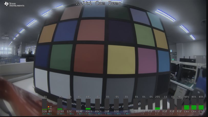

We found a problem during our ISP tuning on IMX390 DISCOVERY, that images of single_cam app are a little different from multi_cam app.
We only enaled one camera for multi_cam app. And for images we took from these two apps, single_cam app always looks lighter.
Or to be more specific, we believe that the white balance of them are different.
Can you tell me is this true, or what's really different if it's not.

  • To exclude the effects of AE and AWB, we force to set analog gain to 1024 and exposure time to 11000, color temperature to 4500, and WB gains to [820, 512, 512, 894].
    Here is how I did:
    And I have made sure those values are written to registers.
    But their images are still different:
  • Another experiment is that we set skipAE and skip AWB to 1
    And there are how they look like:

  • Hi Gang
    I think I found out the reason.
    There are two kinds of wdr config implemented for imx390 d3, 60fps for single_cam and the other one(30 fps) is for multi_cam. These 2 configs are quite different including AE settings.
    There are 3907 bytes of register settings and some of them are modified which are even reserved by sony according to their datasheet.
    so I couldn't understand this config all. Do you have a manual for this?

  • The sensor exposure could be higher in multi-cam at 30fps than single-cam at 60fps.

  • According to the config files:
    Shutter time has been well calculated so exposures are the same.

  • Shutter time has been well calculated so exposures are the same.
    In Brandon's experiment, we see the difference in raw, but did not see any other significant difference caused by VISS.
  • Hi Gang
    Yes, I did some experiments, the most differences are in raw, because of the different config file.
    Now I can have the same images from different apps.
    Thanks for reply and experiments
