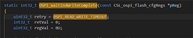

we are currently using the flash driver of the sdk. Currently,
in the wakeup domain, flash can be read and written normally.
After we moved the driver to the mcu domain, we found that it could read and erase, but the write report failed.
This is my modification.
Besides, I found that we are currently stuck at a point where the time has exceeded。
This seems like a custom bare metal application which is being used to load the flash. Can you confirm.
Can you check if the signal being sent out with the write command is the correct one? If that is the case, are we getting anything back from flash?
