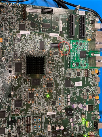

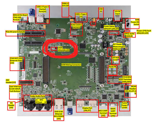

There are two user LEDs on the J721S2 EVM. How to toggle them?
  • Commands and expected board behavior:
    gpioset -c 2 22=0
    gpioset -c 2 22=1

            line  21:       "USER_INPUT1"           input
            line  22:       "USER_LED1"             input
            line  23:       "USER_LED2"             input
