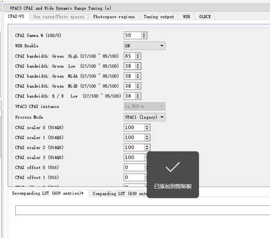

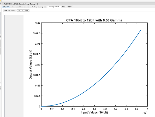

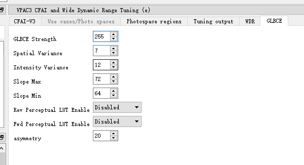

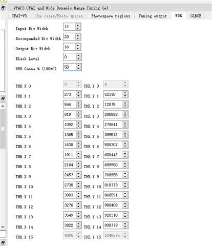

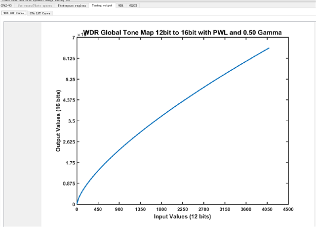

Hi TI Experts
After using the DCC tool to apply WDR, the overall image becomes brighter.
In cases of strong light contrast, the highlights are all white
(for example, when shooting outdoor scenes from indoors, the indoor scene can be seen clearly, but the scene outside the window is white and cannot be seen clearly).
Here is my config:
