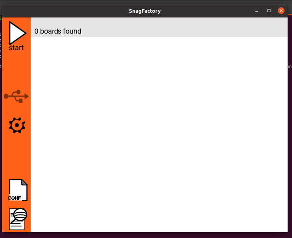

    I installed snagboot normal and GUI by using:
    $ python3 -m pip install --user snagboot
    $ python3 -m pip install --user snagboot[gui]

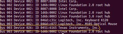

    Then put the board AM62L in USB DFU mode by 0-15 pins are: 11001010 0000 0000
    host: $ lsusb
    host: $ sudo dmesg
    It shows board in DFU mode in dmesg and entry comes in lsusb command.
    Now when I run snagfactory in terminal it opens GUI. But it can't detect any board.
    Is there a configuration file required for board detection—similar to Step 2 mentioned into "How to Use Snagfactory" guide in suggested link?
    Where can I find this configuration file, and do I need to load it before loading the YAML file?
    Parv

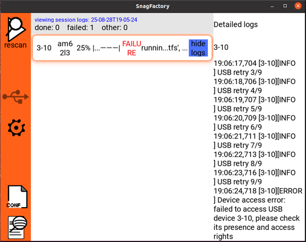

  • Hi Meet,
    I load my configure emmc.yaml file, and snagfactory detect the board.
    After that I start flashing by start button.
    After 25% it fails.

    But I got error in snagrecover command to check recovery binaries are loading properly or not. But I got below error:
    2025-08-29 13:11:37,892 [INFO] Starting recovery of am62l3 board
    2025-08-29 13:11:37,895 [WARNING] Failed to get configuration descriptor for device at 1-1.4!
    2025-08-29 13:11:38,896 [INFO] USB retry 1/9
    2025-08-29 13:11:38,897 [WARNING] Failed to get configuration descriptor for device at 1-1.4!
    2025-08-29 13:11:39,898 [INFO] USB retry 2/9
    2025-08-29 13:11:39,899 [WARNING] Failed to get configuration descriptor for device at 1-1.4!

    2025-08-29 13:11:47,918 [ERROR] Device access error: failed to access USB device 1-1.4, please check its presence and access rights
    Parv
  • Hi Parv,
    The logs still show some issue with the recovery binary as it is not able to access the USB device in u-boot. The bootloader images after make can be found in board-support/built-images/a53, could you confirm if these were the images you used? Please also share your yaml file with me.
    Meet.

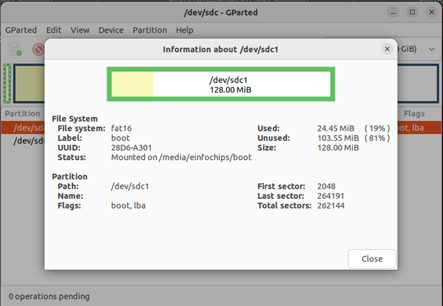

    I also tried DFU to SD card flash. To check how to partitions are done by snagfactory and check with working SD card.
    Here, I shared working sd card disk information and I flashed Sd card by DFU.
    1) Working SD card:

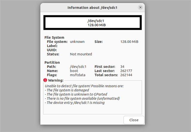

    But we can't set up the file system type of partition.
    We got these details from running all things on SD card.
    We check file system type from gparted tool their SD card shows unknown.
