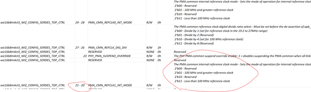

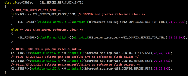

In the function CSL_serdesRefclkSel it seems that the bit PMA_CMN_REFCLK1_INT_MODE of wiz16b8m4ct3_WIZ16B8M4CT3_WIZ_CONFIG_SERDES_TOP_CTRL will only be set if the user has chosen CSL_SERDES_REF_CLOCK_INT1 as the reference clk source.
However in the description of the bitfield I do not understand the connection to the chosen reference clock. From my understanding this bit should be set as soon as you chose a ref clk with >= 100MHz.
Could you please tell me what I am missing? Thank you in advance.
    Yes.
    You can find the condition above refClkSrc is compared with REF_CLOCK_INT1 then only above code will execute/run.
    You can find the below from Register Spec, above is to choose the mode of operation of reference clock as >100MHz or Lower.

    The clock is set to 100MHz and the driver is not properly setting this bit.
    If clock is set to 100MHz, as per code shared top_ctrl was set with 1, which is valid as per register specification.

  • In the driver I configured to use INT0 however the driver only sets the bit for INT1. And I do not see this distinction in the datasheet.
    How are you passing the refclock INT0?
    You should use it as per below.
    serdesLaneEnableParams.refClkSrc = CSL_SERDES_REF_CLOCK_INT0;
