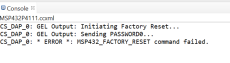

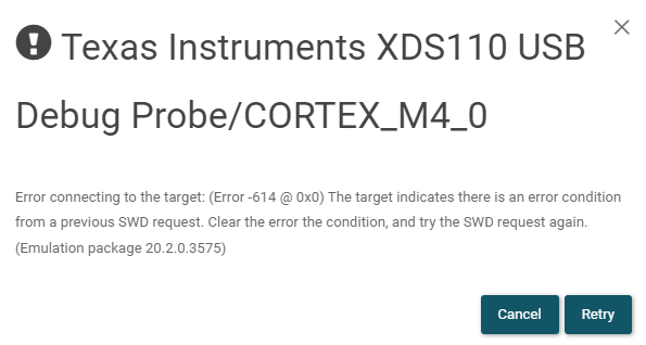

2- I opened Code composer and tried the approach explained in slau575k.pdf to do a factory reset with a password by running a gel script and putting my password in the script, but it did not work and i got this result

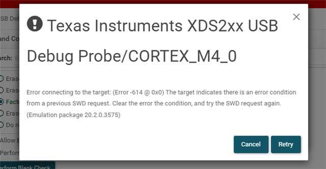

3- Tried to use Uniflash but it is impossible as i always get this result when doing any operation, and also there is no unlock with a password option.

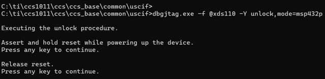

4- I tried running those commands and they dont even run and does not have an option for a password so it is probably not a solution.
    - dbgjtag -f @xds110 -Y unlock,mode=msp432p4
    - dbgjtag -f @xds110 -Y unlock,mode=msp432p4011

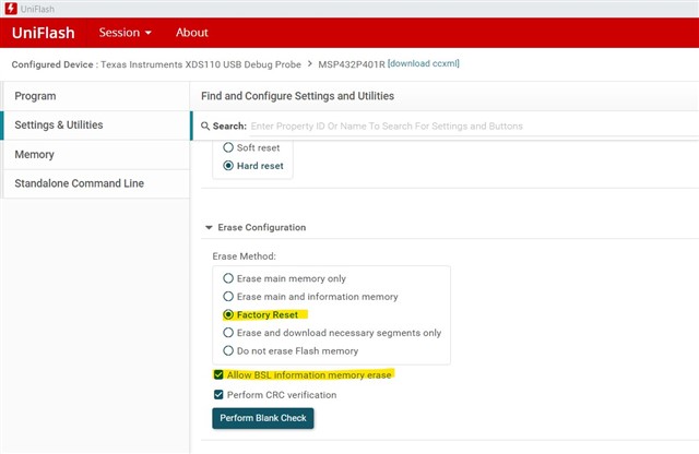

      I must say I have no experience with this device's security feature since this device is EOL for quite a while.  Having said that, I tried the Uniflash and I selected Factory Reset and it is erasing the flash.
    I also tried the dbgjtag.exe under CCS10 and it is also erasing the flash. See below. When I use CCS12, it is giving an "Error: The sub-argument for option [-f] is missing." I will suggest you use CCS10.
  • but where to write the password?

      I suppose you have an XDS200 debug probe, correct?
      Do you have any board that is NOT currently locked? It will be good if you have any board that has a empty flash on the MCU. If you do, can you:
      - Use the Uniflash and XDS200 to load a simple program such as a blinky program to toggle a LED or GPIO pin
      - If you can get the above the work then it means the XDS200 is working as well as the Uniflash. If you can't even load a simple program then it is meaningless to spend time on how to unlock your currently locked MCU
      - If you can use the Uniflash and XDS200 to load a simple program successfully then you can try the Factory Reset command on this simple program. Can you get the Uniflash+XDS200 to reset this MCU?
      - If you can the Factory Reset to work on the above then you can continue on the locked MCU

  • I have flashed a software on an unlocked board using XDS200 and Uniflash and it was flashed and functional than i tested the factory reset, using uniflash and XDS200 and with the correct settings you sent before, and it does the factory reset successfully without any errors and the board gets erased.
    What are the next steps?

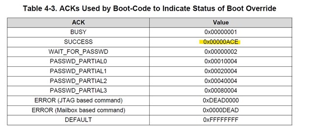

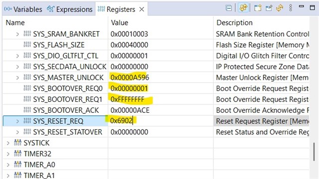

  • The Uniflash Factory Reset is supposed to perform the below operations. Why don't you manually do the same in CCS and see its effect on your locked boards. See below image.
    1. Write 0xA596 to SYS_MASTER_UNLOCK
    2. Write 0x01 to SYS_BOOTOVER_REQ0
    3. Write 0xFFFFFFFF to SYS_BOOTOVER_REQ1
    4. Write 0x6902 to SYS_RESET_REQ
    After the above operations, the SYS_BOOTOVER_ACK will become 0xACE indicating success.
