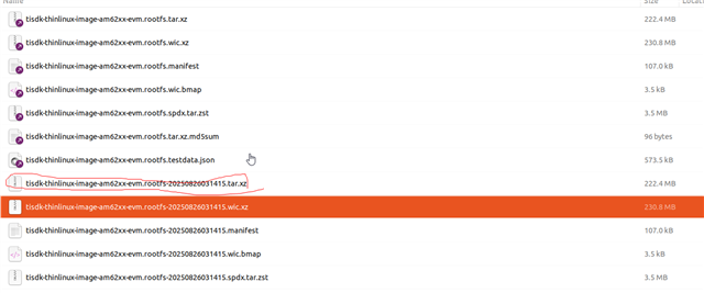

  • Hello Bin,
    In my Yocto project, it generates some rootfs, but I have never used the WIC image. I only the .tar.xz rootfs.
  • Hi Yongyan,
    Note: "oeconfig-file" is "processor-sdk-scarthgap-chromium-11.01.05.03-config.txt", "machine" is "am62xx-evm".
    For AM62P, the "machine" should be "am62pxx-evm" but not "am62xx-evm".

  • Ok
    I change the machine type from Ap62xx to Am62px. Then It is ok. Thanks.
