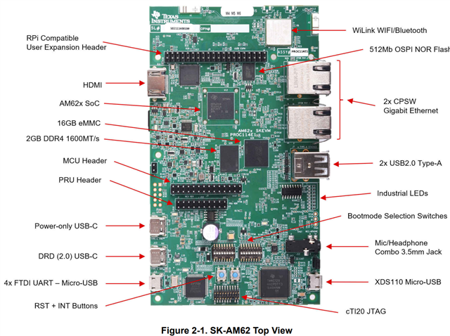

Test EVM: SK-AM62

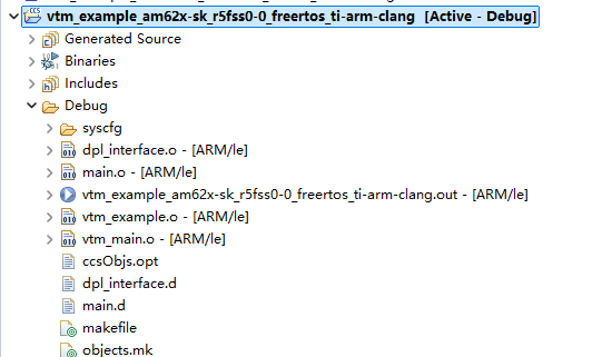

I imported the example from C:\ti\mcu_plus_sdk_am62x_10_01_00_33\examples\sdl\vtm\vtm_uc\am62x-sk\r5fss0-0_freertos
Then, I compiled the R5 projects and copied the generated appimage.hs_fs into the below path.
