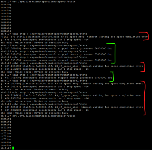

when i try to stop an r5f core i get this error
[  634.928644] platform 5e00000.r5f: k3_r5_rproc_stop: timeout waiting for rproc completion event
[  634.937253] remoteproc remoteproc0: can't stop rproc: -16
sh: echo: write error: Device or resource busy

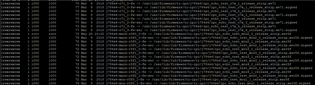

the following image serves as proof of the behaviour I'm getting. in red are the r5f colours that won't stop because the resource is busy and in green are the dsps that manage to stop.
the following image lists the default applications running on each core

    Sure. please find the following commands and logs:
    cd /lib/firmware
    ln -sf ~/ipc_echo_test_freertos_mcu2_0_release.xer5f j784s4-main-r5f0_0-fw
    echo start > /sys/class/remoteproc/remoteproc0/state
    [  171.509285] remoteproc remoteproc0: powering up 5c00000.r5f
    [  171.523182] remoteproc remoteproc0: Booting fw image j784s4-main-r5f0_0-fw, size 781652
    [  171.532213] rproc-virtio rproc-virtio.8.auto: assigned reserved memory node r5f-dma-memory@a2000000
    [  171.541889] virtio_rpmsg_bus virtio0: rpmsg host is online
    [  171.547435] rproc-virtio rproc-virtio.8.auto: registered virtio0 (type 7)
    [  171.554222] remoteproc remoteproc0: remote processor 5c00000.r5f is now up
    echo stop > /sys/class/remoteproc/remoteproc0/state
    [  203.310824] platform 5c00000.r5f: k3_r5_rproc_stop: timeout waiting for rproc completion event
    [  203.319444] remoteproc remoteproc0: can't stop rproc: -16

  • Hi Joao,
    I was able to reproduce the issue:
    echo stop > /sys/class/remoteproc/remoteproc7/state
    [  105.151067] platform 5d00000.r5f: k3_r5_rproc_stop: timeout waiting for rproc completion event
    [  105.159691] remoteproc remoteproc7: can't stop rproc: -16
    -sh: echo: write error: Device or resource busy
    Couple of changes need to be done:
    1. This is only supported in the remoteproc mode and not in the IPC only mode. If U-Boot loads firmware then the Linux will not be able to stop & start.
      So in the uEnv.txt of the boot partition of the SD card:
      1. setenv dorprocboot 0
      2. Comment the overlay lines.
        # Setting the right U-Boot environment variables
        dorprocboot=0
        #name_overlays=ti/k3-j784s4-evm-ethfw.dtbo ti/k3-j784s4-vision-apps.dtbo
    2. The default /lib/firmware point to vision_apps firmware & that is not validated with graceful shutdown. Only the ipc_echo_test firmware are validate with graceful shutdown:
      ln -sf /usr/lib/firmware/ti-ipc/j784s4/ipc_echo_test_mcu2_1_release_strip.xer5f /lib/firmware/j784s4-main-r5f0_1-fw
      ln -sf /usr/lib/firmware/ti-ipc/j784s4/ipc_echo_test_mcu2_0_release_strip.xer5f /lib/firmware/j784s4-main-r5f0_0-fw
    With the above 2 changes the stop/start works:
    echo stop > /sys/class/remoteproc/remoteproc11/state
    [   93.650232] remoteproc remoteproc11: stopped remote processor 5d00000.r5f
    root@j784s4-evm:~# echo stop > /sys/class/remoteproc/remoteproc10/state
    [  102.726280] remoteproc remoteproc10: stopped remote processor 5c00000.r5f
    root@j784s4-evm:~# echo start > /sys/class/remoteproc/remoteproc10/state
    [  110.485526] remoteproc remoteproc10: powering up 5c00000.r5f
    [  110.492328] remoteproc remoteproc10: Booting fw image j784s4-main-r5f0_0-fw, size 82648
    [  110.501416] rproc-virtio rproc-virtio.9.auto: assigned reserved memory node r5f-dma-memory@a2000000
    [  110.510998] virtio_rpmsg_bus virtio1: rpmsg host is online
    [  110.516539] rproc-virtio rproc-virtio.9.auto: registered virtio1 (type 7)
    [  110.523333] remoteproc remoteproc10: remote processor 5c00000.r5f is now up
    [  110.525872] virtio_rpmsg_bus virtio1: creating channel ti.ipc4.ping-pong addr 0xd
    root@j784s4-evm:~# [  110.537862] virtio_rpmsg_bus virtio1: creating channel rpmsg_chrdev addr 0xe
    root@j784s4-evm:~# echo start > /sys/class/remoteproc/remoteproc11/state
    [  118.269523] remoteproc remoteproc11: powering up 5d00000.r5f
    [  118.276294] remoteproc remoteproc11: Booting fw image j784s4-main-r5f0_1-fw, size 82648
    [  118.285340] rproc-virtio rproc-virtio.10.auto: assigned reserved memory node r5f-dma-memory@a3000000
    [  118.295083] virtio_rpmsg_bus virtio2: rpmsg host is online
    [  118.300632] rproc-virtio rproc-virtio.10.auto: registered virtio2 (type 7)
    [  118.307524] remoteproc remoteproc11: remote processor 5d00000.r5f is now up
    [  118.309780] virtio_rpmsg_bus virtio2: creating channel ti.ipc4.ping-pong addr 0xd
    root@j784s4-evm:~# [  118.322064] virtio_rpmsg_bus virtio2: creating channel rpmsg_chrdev addr 0xe
    Keerthy

    [   52.270069] platform 5c00000.r5f: k3_r5_rproc_stop: timeout waiting for rproc completion event
    [   52.278684] remoteproc remoteproc6: can't stop rproc: -16
