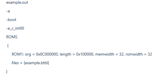

    The RMD file contains , the following informations:-
      • The application .out file has to be flashed
      • -a for the output hex format in ASCII
      • -e the entry point for the address. i.e._c_init00
      • Output file that contains the application .out in bootable format
      • Memory sections with the MEM and ROW WIDTH
    Create a rmd file example.rmd using the editor as follows:
    Run hex6x with example.rmd "hex6x example.rmd"
