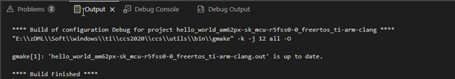

In my windows compute,  I install the CCS 20.2.0 Version. When I compile the Demo "Hello World". There is no error in "Output" view(Figure 1).
But when I load the Program, there is a error(Figure 2).

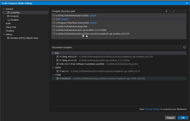

Note: In my CCS project configuration as Figure 3.(Compilers Configuration)
                           Figure 1
                      Figure 2
              Figure 3
Look forward to your reply!

    So I guess there might be something wrong with my compilation configuration. "Figure 3" is my configuration. Now I don't know which configuration is wrong?
  • Can you provide all the build messages in the build console? You can copy and paste to a text file and then attach the file to this thread.
  • hello bro:
    The attachment is the build Step.
    [0]**** Clean-only build of configuration Debug for project hello_world_am62px-sk_mcu-r5fss0-0_nortos_ti-arm-clang ****
    [1]"E:\\zDML\\Soft\\windows\\ti\\ccs2020\\ccs\\utils\\bin\\gmake" -k -j 12 clean -O
    [2]**** Build Finished ****
    [3]**** Build of configuration Debug for project hello_world_am62px-sk_mcu-r5fss0-0_nortos_ti-arm-clang ****
    [4]"E:\\zDML\\Soft\\windows\\ti\\ccs2020\\ccs\\utils\\bin\\gmake" -k -j 12 all -O

  • I noticed you are using different version of SysConfig / SDK / Compiler so set up my project to match yours. However I still do not see any issue. I will need to discuss with compiler experts to see if they have any suggestions.
  • OK
    Thanks.
  • By the way,
    I remember,
    when I install CCS software, the Sysconfig and the Compiler tool will be installed automatically.
  • when I install CCS software, the Sysconfig and the Compiler tool will be installed automatically.
    Did you install the SDK from Resource Explorer? Installing from there would also pick up the compiler and sysconfig versions that it has dependencies for. The examples in SDK 11.0.0.16 seems to have been created with SysConfig 1.23.0 and compiler 4.0.1.
    In any case, the SysConfig and compiler versions are not the issues here. I had a compiler expert analyze the *.out file you attached and he is certain the final output is not from the TI compiler. He suspects it has been modified after the TI compiler generated it. Is there any post processing done on the *.out file after the project build?
