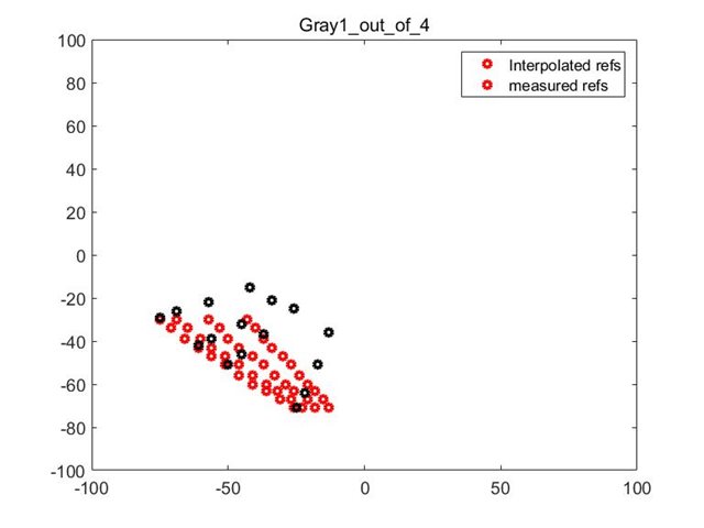

  • Hi meng,
    Your AWB calibration output does not look good.
    Please follow "7.6.2 Tuning AWB" in the app note in the link below carefully.
    https://www.ti.com/lit/pdf/sprad86

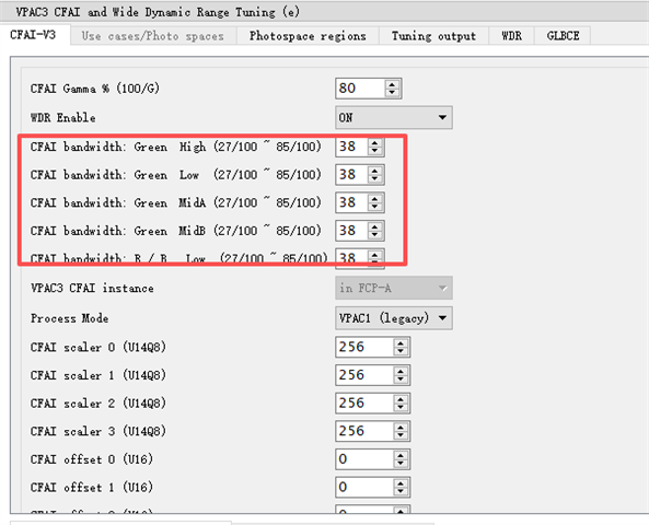

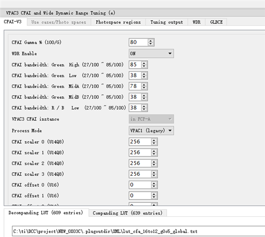

    I suspect the issue may be with the CFAI+WDR process (my workflow is BLC -> CFAI+WDR -> AWB -> ColorCorrection).
    here is my cfai config params
    I tried to change CFAI bandwidth green(High Low Mid), but seemed not work

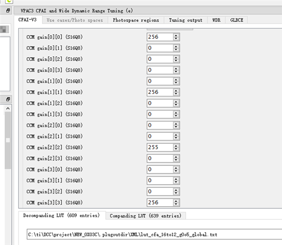

    Do I need to change CCM gain?
    Best Regards
    Meng
