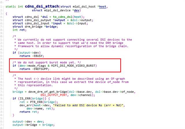

I attempted to connect a MIPI display to the DSI interface exposed on the AM62L and expected it to function properly. However, the driver exits abnormally during probe, and the mipi_dsi_attach function returns an error code. From the function code, I can see that the error occurs because the ops (operations) function pointer in the DSI device structure’s host field is NULL. Could this be due to an issue in my device tree configuration causing the attach operation to fail?

And this is  the edit part base on k3-am62l3-evm.dts
	drm_panel_add(&ctx->panel);
	dsi->format = MIPI_DSI_FMT_RGB888;
	dsi->lanes = 4;
	dsi->mode_flags = MIPI_DSI_MODE_VIDEO | MIPI_DSI_MODE_VIDEO_BURST | MIPI_DSI_MODE_VIDEO_HSE | MIPI_DSI_MODE_LPM;
	ret = of_property_read_u32(dsi->dev.of_node, "video-mode", &video_mode);
	if (!ret) {
		dsi->mode_flags = video_mode;
	dev_info(&dsi->dev, "dsi video mode[0x%lx]\n", dsi->mode_flags);
	return mipi_dsi_attach(dsi);
this is the probe func where it exit,when it enter probe,it will exit from mipi_dsi_attach,is  there something wrong with dsi host ?
    1. Can you please try defining dsi0 node and panel node as done in: https://git.ti.com/cgit/ti-linux-kernel/ti-linux-kernel/tree/arch/arm64/boot/dts/ti/k3-am62l3-evm-dsi-rpi-7inch-panel.dtso?h=ti-linux-6.12.y
    2. Please share dmesg logs.
    3. Which file are you looking into for the mipi_dsi_attach function observation?

    [   20.287133] panel-aml070wxii4006 30500000.dsi.0: dsi video mode[0x813]
    [   20.406131] panel-aml070wxii4006 30500000.dsi.0: probe with driver panel-aml070wxii4006 failed with error -524

    3.I found the mipi_dsi_attach func in ti-linux-kernel-6.12.24+git-ti-rt\drivers\gpu\drm\drm_mipi_dsi.c  to check the error code,The mipi_dsi_attach function is called in a panel driver file: ti-linux-kernel-6.12.24+git-ti-rt\drivers\gpu\drm\panel\panel-amelin-aml070wxii4006.c. This file was added by myself this is its prboe func
    static int aml070_panel_dsi_probe(struct mipi_dsi_device *dsi)
    	struct aml070_panel *ctx;
    	int ret;
    	u32 video_mode;
    	ctx = devm_kzalloc(&dsi->dev, sizeof(*ctx), GFP_KERNEL);
    	if (!ctx)
    		return -ENOMEM;
    	ctx->supply = devm_regulator_get(&dsi->dev, "vcc-lcd");
    	if (IS_ERR(ctx->supply))
    		return PTR_ERR(ctx->supply);
    	mipi_dsi_set_drvdata(dsi, ctx);
    	ctx->dsi = dsi;
    	drm_panel_init(&ctx->panel, &dsi->dev, &aml070_panel_funcs, DRM_MODE_CONNECTOR_DSI);
    	ctx->gpios.reset = devm_gpiod_get(&dsi->dev, "reset", GPIOD_OUT_LOW);
    	if (IS_ERR(ctx->gpios.reset)) {
    		dev_err(&dsi->dev, "Couldn't get our reset GPIO\n");
    		return PTR_ERR(ctx->gpios.reset);
    	ctx->backlight = devm_of_find_backlight(&dsi->dev);
    	if (IS_ERR(ctx->backlight)) {
    		dev_err(&dsi->dev, "Couldn't get our backlight\n");
    		return PTR_ERR(ctx->backlight);
    	dsi->lanes = 4;
    	if (!ret) {
    It is completely fine if your panel doesn't use a bridge, but I would have expected the panel to probe even from within &{/}.
    Since you are using a custom driver, have you validated it against any other SoC/EVM platform?
    This most likely seems to be the panel driver issue and I would recommend seeking help from the panel vendor for the same.
  • Hi Divyansh,
    Yes, this driver has been verified to function properly on NXP's i.MX8MP platform, but it has not been tested on TI platforms
  • Hi,I found that the error occurs because the system does not support MIPI_DSI_MODE_VIDEO_BURST. And now it works
