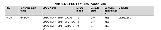

  • Hi Kevin,
    Refer to TDA4VEN DDRSS TRM
    the base address of psc_MDCTL is 0x00400A00 and below is offset of LPSC 72/73/74 which is for DDR32SS0
    72 x 4 = 0x120
    73 x 4 = 0x124
    74 x 4 = 0x128
    We flow the below steps to reset and enable LPSC 72/73/74, Could you please help to check if this sequence can fully reset DDR32SS0?
    -1-
    set LPSC to SyncRst through register psc_MDCTL (bit 4:0)
    -2-
    set GO bit to 1 in register psc_PTCMD (0040 0120h)
    -3-
    waiting for cmd done through psc_PTSTAT(0040 0128h)
    -4-
    set LPSC to Enable through register psc_MDCTL (bit 4:0)
    -5-
    -6-
    Joe

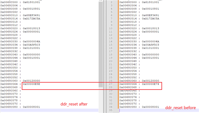

  • Hi Kevin,
    Below are register dump about PLL12 and DDR. It seems only one bit is different in PLL12. Could you please take a look? Thanks
    1. DDR init micron parameters
    2. pll12 0068c000-0068c080
    reg[0x68c000]:val[0x61801001]
    reg[0x68c008]:val[0x10801]
    reg[0x68c010]:val[0x68ef3491]
    reg[0x68c014]:val[0xd172bc5a]
    reg[0x68c020]:val[0x18013]
    reg[0x68c024]:val[0x1]
    reg[0x68c030]:val[0x4a]
    reg[0x68c034]:val[0xa8f5c3]
    reg[0x68c038]:val[0x1010001]
    reg[0x68c040]:val[0x80000000]
    reg[0x68c044]:val[0x10001]
    reg[0x68c060]:val[0x120000]
    reg[0x68c064]:val[0xe7e]
    reg[0x68c080]:val[0x8001]
    3. MR5 read ID
    4. ddr_reset
    5. pll12 0068c000-0068c080
