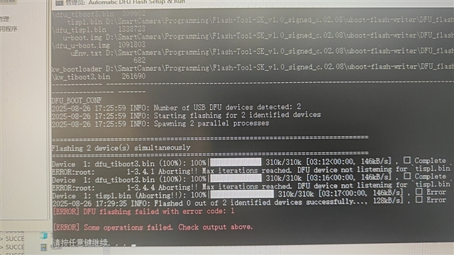

     Now, We want to upgrade the device type from HS_FS to HS_SE.
    The step is that
     1. Enable VPP, flash the kw_tiboot3 to SoC by USB util, and the Disable VPP. ---> the step is successful
     2. At once, flash the images to SoC by USB utils , the dfu image is signed by the correct key ---> the step is failed
     3. If powered off and on the SoC after step 1,  repeat the step 2 that flash the image is successfully.
So we want to ask what can we do by software control, We can flash key and image combined into one step that can enhance the efficiency of produce.
Toby
  • 2. At once, flash the images to SoC by USB utils , the dfu image is signed by the correct key ---> the step is failed
    How are you flashing the images as the keywriter doesn't have the USB support?
  • After flashing KEY, the kw-boot3.bin will execute reboot, which leads AM62A7 warm reset.
    Then, We will process dfu_flash.py script to flash images. This step is failed.
    log is above
    Now, After flashing key, we need hard reset, and then process dfu_flash.py script to flash images. This step is OK
    So,  Is the process of hard reset  mandatory between flashing key and flashing images?
    We want to flash key and image combined into one step that can enhance the efficiency of produce.
    what should we do?
  • We want to flash key and image into one step, and don't need to hard reset what should we do?
  • After flashing the keys, the device is converted to HSSE only after a cold reset. If you do a warm reset then the device would still be in HSFS state.
    You should boot the HSFS DFU images while flashing the HSSE images.
