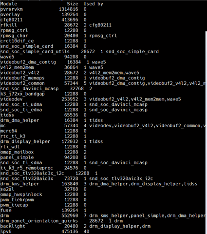

I would like to know how these below modules are loaded automatically? I cannot find the related configuration files. if I want reduce some modules, Which file should I modify.

Are you using yocto to build these modules?
IMAGE_INSTALL:append = " kernel-modules" would include the modules in the final image that gets built.
