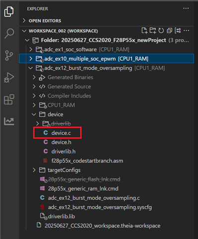

The user reported CCS 20.2 seems to link to wrong file for definition if the files are in the same name in different projects.
Steps to reproduce this issue.

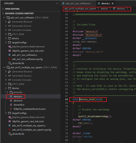

Step 1: Open several examples together in a workspace
Import three ADC example codes from TI C2000ware
C:\ti\c2000\C2000Ware_5_04_00_00\driverlib\f28p55x\examples\adc
Like this, and notice there is a device.c for each project.

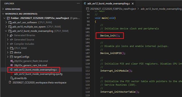

Step 2:

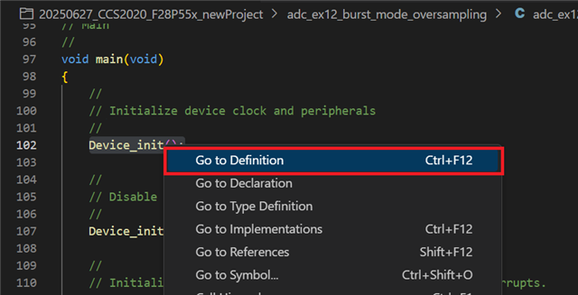

Go to a function call like
Device_init();
Go to the definition of Device_init();
You should see it correctly goes to device.c in
~\adc_ex12_burst_mode_oversampling\device\device.c

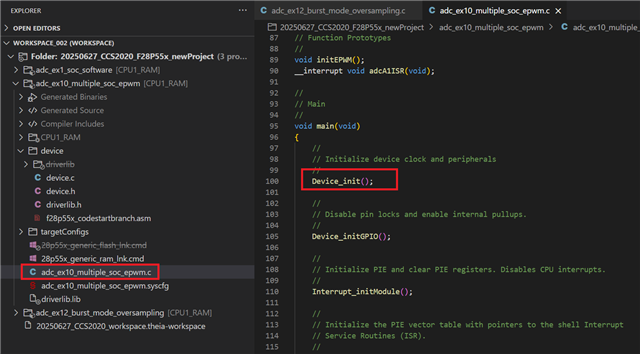

Step 3:
Repeat the above in another project like adc_ex10_multiple_soc_epwm.c.

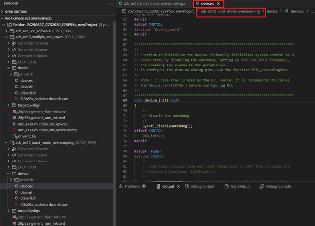

Go to its definition of Device_init();
Then, you will see it still links to Device_init(); in the device.c in ex12 rather than that in ex10.
In other words, CCS links to the wrong definition in ex12, and it's supposed to be that in ex10.

    Based on your first screenshot it looks like the customer once had a multi-root workspace environment and then removed one of the roots (folder) to have a single root workspace save to the workspace file. That single root (20250627_CCS2020_F28P55x_newProject) contains three projects.
    Is that correct?

    The user had two tests independently. One is with MSPM0 using multi-root workspace and the other is with C2000 using single root containing three projects. Both tests have this issue.
  • the other is with C2000 using single root containing three projects. Both tests have this issue.
    Can you try a pure single root workspace environment inside of the environment you currently have where it originally was a multi-root environment with on of the roots removed? Basically use the option to open a folder to the folder containing the three projects. The environments sounds similar but there are actually treated differently by CCS under the hood.

    I tried with a pure single root workspace environment by using File->Open Folder and imported two C2000 example projects below.
    The result still failed and is the same as the above.
    Note that the user and I have done three independent tests using MSPM0 and C2000 examples, and we can reproduce it easily.
    It still links to the wrong definition.
    BTW, if I deleted adc_ex10 above and left only one project adc_ex1 above, then the linking could be correct. That is, it seems when more than one project are imported in the same workspace, then this issue can happen.
