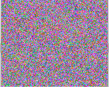

TDA4VM: Why the capture node's output picture is not normal?
Part Number: TDA4VM
I'm using rewrite an app using the capture node, the camera is ar0233, and it seems ok, but when i write the output image of capture node,it seems that the capture node doesn't work normally. It output the picture like bellow,did i miss some configuration of the capture node?

  • Hi cheng,
    Most likely, its not capturing anything and this is just dummy frame from the framework.
    Can you please make sure that
    - CSIRX is configured with the correct number of lanes and lane ordering
    - CSIRX is configured with the correct datatype and virtual channel id
    - CSIRX is configured with the correct lane speed, which is matching with the output from deserializer
    - Output from deserializer is enabled only after PHY is configured and not before it.
