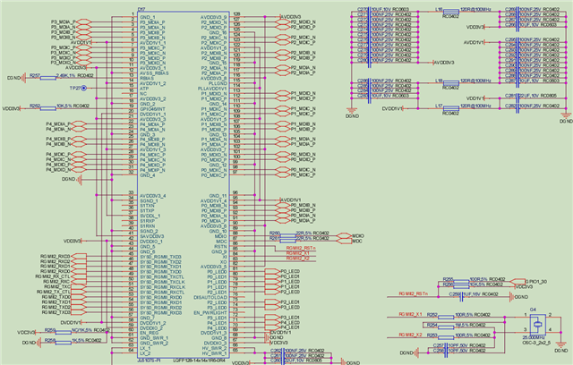

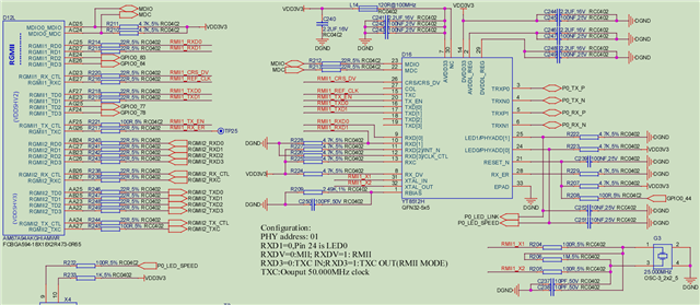

AM67A: How to connect the switch chip
Part Number: AM67A
On our equipment, there is a phy chip (rmii) and a switch chip (rgmii). However, so far, only the phy chip has been successfully connected, while the switch has been unable to read/write to the registers. Here is the schematic diagram.
 I made the following modifications in the k3-j722s-evm.dts and the davinci_mdio.c.
	rmii1_pins_default: rmii1-default-pins {
		pinctrl-single,pins = <
			J722S_IOPAD(0x0130, PIN_INPUT, 1) /* (AG26) RGMII1_TXC.RMII1_CRS_DV */
			J722S_IOPAD(0x0148, PIN_INPUT, 1) /* (AE27) RGMII1_RXC.RMII1_REF_CLK */
			J722S_IOPAD(0x014c, PIN_INPUT, 1) /* (AC25) RGMII1_RD0.RMII1_RXD0 */
			J722S_IOPAD(0x0150, PIN_INPUT, 1) /* (AD27) RGMII1_RD1.RMII1_RXD1 */
			/* J722S_IOPAD(0x0144, PIN_INPUT, 1) /* (AD23) RGMII1_RX_CTL.RMII1_RX_ER */
			J722S_IOPAD(0x0134, PIN_OUTPUT, 1) /* (AF27) RGMII1_TD0.RMII1_TXD0 */
			J722S_IOPAD(0x0138, PIN_OUTPUT, 1) /* (AE23) RGMII1_TD1.RMII1_TXD1 */
			J722S_IOPAD(0x012c, PIN_OUTPUT, 1) /* (AF25) RGMII1_TX_CTL.RMII1_TX_EN */
	rgmii2_pins_default: rgmii2-default-pins {
			J722S_IOPAD(0x00f8, PIN_INPUT, 2) /* (AB24) VOUT0_HSYNC.RGMII2_RD0 */
			J722S_IOPAD(0x00fc, PIN_INPUT, 2) /* (AC27) VOUT0_DE.RGMII2_RD1 */
			J722S_IOPAD(0x0100, PIN_INPUT, 2) /* (AB23) VOUT0_VSYNC.RGMII2_RD2 */
			J722S_IOPAD(0x0104, PIN_INPUT, 2) /* (AC26) VOUT0_PCLK.RGMII2_RD3 */
			J722S_IOPAD(0x00f4, PIN_INPUT, 2) /* (AB27) VOUT0_DATA15.RGMII2_RXC */
			J722S_IOPAD(0x00f0, PIN_INPUT, 2) /* (AB26) VOUT0_DATA14.RGMII2_RX_CTL */
			J722S_IOPAD(0x00e0, PIN_OUTPUT, 2) /* (AA25) VOUT0_DATA10.RGMII2_TD0 */
			J722S_IOPAD(0x00e4, PIN_OUTPUT, 2) /* (AB25) VOUT0_DATA11.RGMII2_TD1 */
			J722S_IOPAD(0x00e8, PIN_OUTPUT, 2) /* (AA23) VOUT0_DATA12.RGMII2_TD2 */
			J722S_IOPAD(0x00ec, PIN_OUTPUT, 2) /* (AA22) VOUT0_DATA13.RGMII2_TD3 */
			J722S_IOPAD(0x00dc, PIN_OUTPUT, 2) /* (AA27) VOUT0_DATA9.RGMII2_TXC */
			J722S_IOPAD(0x00d8, PIN_OUTPUT, 2) /* (AA24) VOUT0_DATA8.RGMII2_TX_CTL */
&cpsw3g {
	status = "okay";
	pinctrl-names = "default";
	pinctrl-0 = <&rmii1_pins_default
				&rgmii2_pins_default>;
&cpsw3g_mdio {
	status = "okay";
	pinctrl-0 = <&mdio_pins_default
				&rmii1_rst_pins_default
				&rmii2_rst_pins_default>;
	rmii1-reset-gpios = <&main_gpio0 44 GPIO_ACTIVE_HIGH>;
	rmii2-reset-gpios = <&main_gpio1 30 GPIO_ACTIVE_HIGH>;
	cpsw3g_phy0: ethernet-phy@1 {
		reg = <1>;
		ti,rx-internal-delay = <DP83867_RGMIIDCTL_2_00_NS>;
		ti,fifo-depth = <DP83867_PHYCR_FIFO_DEPTH_4_B_NIB>;
		ti,min-output-impedance;
	cpsw3g_phy1: ethernet-phy@0 {
		reg = <0>;
&cpsw_port1 {
	phy-mode = "rmii";
	phy-handle = <&cpsw3g_phy0>;
&cpsw_port2 {
	phy-mode = "rgmii";
	phy-handle = <&cpsw3g_phy1>;
