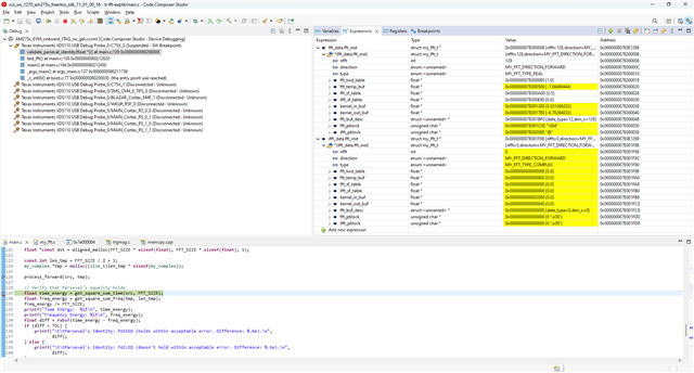

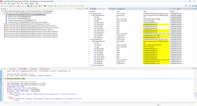

    Before process_forward(), the fft_data.fft_inst and ifft_data.fft_inst looked normal:
    After process_forward(), the ifft_data.fft_inst looked wrong:
    You need to check your program closely.

  • Hi Hendry,
    I think the issue is with the following code:
    FFTLIB_fft1dBatched_i32fc_c32fc_o32fc_init (
       (FFTLIB_F32 *) pX, &bufParamsX_FFT, (FFTLIB_F32 *) pW,
       &bufParamsX_FFT, (FFTLIB_F32 *) pXFFT, &bufParamsX_FFT,
       (numPoints >> 1), 1, &((uint8_t *) pBlock)[5 * SE_PARAM_SIZE]);
    The pBlock for FFT instance is 14*64, but inside FFTLIB_fft1dBatched_i32fc_c32fc_o32fc_init(), 13*64 have been used (see SA_LOOP6_PARAM_OFFSET). Plus the 5*64 used in FFTLIB_fft_real_forward_init(). There should be at least 18*64 for the FFT instance pBlock.
    Once I changed:
    me->fft_pblock = (uint8_t *) memalign(FFTLIB_BUFFER_ALIGNMENT_REQ, FFT_PBLOCK_SIZE);
    memset((void *)me->fft_pblock, 0, FFT_PBLOCK_SIZE);
    TO
    me->fft_pblock = (uint8_t *) memalign(FFTLIB_BUFFER_ALIGNMENT_REQ, IFFT_PBLOCK_SIZE);
    memset((void *)me->fft_pblock, 0, IFFT_PBLOCK_SIZE);
    The program works as expected.
