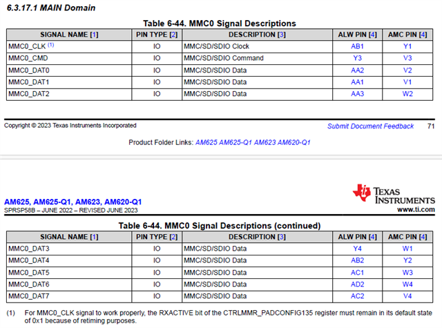

    We are using the PSE2A0SL-08GX eMMC. This eMMC includes a Data Strobe (DS) pin. Currently, we have connected the DS pin to the W18 pin of the SoC (since it is a free pin, as we are using only a single Ethernet channel). Is this the correct connection? If not, please suggest the proper pin to which it should be connected.
    Am625 dos not support DS pin.
    You can add a pulldown and a TP as a provision for probing.
    FYI, CALPAD and DS pins are supported on the eMMC hard macro PHY that supports HS400 speed
    Sreenivasa

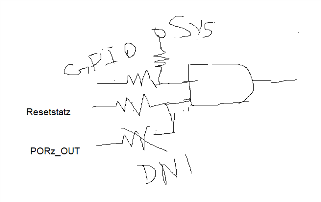

    PORz_OUT Remove shorting from R178 resistor
    Connect an SOC IO with a 10K pullup to one of the ANDing logic input for local reset
    Connect PORz_OUT and RESETSTATz through separate 0R resistors to the other AND gate input.
    Populate 0R for RESETSTATz and DNI series resistor for PORz_OUT initially
    Sreenivasa
  • In your last comments regarding PORz_OUT and RESETSTATz, both signals are connected to multiple AND gates. Therefore, 0Ω resistor is required for each AND gate, so that we can implement only the ones we need. Is this what you meant? Please confirm. Please share the remaining review points as well, so we can implement them simultaneously.
  • Hello Surinder Sharma,
    In the schematics, there is a 2 input AND gate.
    Please follow below connection.
    Sreenivasa

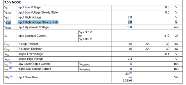

    10V cap used for 12V supply
    Use 25V or above

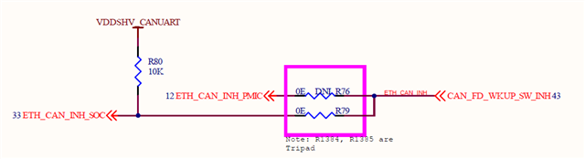

    CAN_TX U8
    SOC IO buffers are off during reset
    Add parallel pull in case the input can float
    Suggest adding a pullup

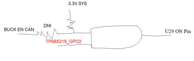

    CAN_VIO_3.3V uC
    Connected to SOC IO
    Connecting a 100nF cap directly to the SOC output is not recommended
    Reduce the cap value to 22pF
    Move R148 near to the VIO pin5 of U9
    BUCK EN CAN
    Connected to U29 load switch EN
    PMIC GPIO open daring output is also connected.
    SN74AHC1G08 Single 2-Input Positive-AND Gate
    Use a open drain output type AND gate
    Sreenivasa
    Please explain the BUCK EN CAN connection to U29. Our requirement is that, if in the future we need to control this load switch through the SoC, we should be able to do so.
    Is this suggested by you as per the attached picture?
    Please confirm.
  • Hello Surender
    The above option is Ok but the gate may not be required.
    PMIC GPIO is Open drain output
    choose below
    SN74AHC1G09 Single 2–Input Positive-AND Gate With Open-Drain Output
    It is Ok to short 2 open drain outputs and connect a common resistor to perform ANDing.
     https://e2e.ti.com/support/logic-group/logic/f/logic-forum/865215/faq-with-open-drain-outputs-can-i-use-them-to-shift-a-logic-voltage-level-connect-the-outputs-directly-together-force-a-voltage-node-to-zero
    With an open-drain output, there is no danger of one output being HIGH and another being LOW since all outputs are either LOW or Hi-Z. In the above image we show how three open-drain buffers can be combined to produce a 3-input AND gate function. It is important to note that the output signal has the same limitation as the previous use-case: the signal can either be fast or low power, but not both.
    Sreenivasa
  • Hi Sir,
    I’m a little confused in this case. Could you please draw the input and output connections of the SN74AHC1G09?
  • Hello Surender
    Thank you.
    You can retain the current connections and only replace the AND gate with open drain output type.
    The switch will be enabled when both signals are high.
    Please read the FAQ linked above for explanation.
    I missed seeing the 0R in your diagram above.
    In case you are considering populating any one of the option, the current design should work. No change.
    In case you want to OR both signals, you may have to use an OR gate and connect as you have shown in the above diagram copied below (gate needs to change to OR gate)
    Sreenivasa

    SD CARD LOAD SWITCH RESET LOGIC
    Use RESETSTAtz and SOC IO
    SOC IO performs local reset
    Add a pullup 10K for the SOC IO input near to the AND gate
    Refe SK schematics

    CPSW_RGMII1_RESETn
    PORz_OUT and RESETSTATz used
    Use SOC IO instead or PORz_OUT to be able to perform local reset
    Add provision to connect PORz_OUT or RESETSTATz
    Configure for RESETSTATz

  • Yes, We can use CAN wake-up, We are using TCAN1043 (Page 3), When any CAN message occur from vehicle then SoC get wake-up,
    I'm not understanding about the implementation of attached image.
    Could you please clarify:
    • Where should the CAN_FD_WKUP_SW_INH net be connected?
    • Is this circuit required if we are already using the TCAN1043’s CAN message wake-up feature?
    Sreenivasa

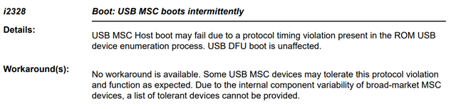

  • Hello Surender,Sharma,
    Please refer Errata regarding the USB host (MSC) boot.
    https://www.ti.com/lit/er/sprz487f/sprz487f.pdf
    You might have to use the USB DFU (device) configuration.
    Sreenivasa

    Please read the Errata regarding the issues with the USB MSC boot.
    Sreenivasa
