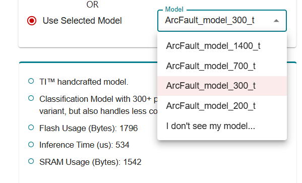

Hello TI Dev,
EdgeAI model composer provides a training platform for arc fault where there are several model selection for arc fault as shown in figure below. I am wondering whether those numbers (200,300,700,1400) are referred to. Do they represent time step?

  • Hello Key,
    The numbers in the model name represent the number of parameters, memory footprint and computational requirements.   See below
    • ArcFault_model_200: smallest memory footprint and computation requirement.
    • ArcFault_model_300: more model parameters for improved performance.
    • ArcFault_model_1400: most model parameters for best performance.
    This allows you to trade off between the memory, computational and performance requirements of  your application.

  • Hello Sopheap,
    The numbers (200,300,700,1400) refer to the approximate number of parameters in the model.
    The smallest model (ArcFault_model_200_t) has the smallest number of parameters, which implies they will take the least amount of time to execute (fastest inference time), but the downside is also that since there are only 200 learnable parameters available, the model has limited learning capability. This means that this is best suited for simpler datasets
    On the other hand, the model_1400_t has about 1400 parameters. It is the slowest to run out of the 4 models, but has the best learning capability. This would best be suited for complex environments.
    To summarize:
    In terms of model performance (inference time): 200_t(fastest)-->300_t-->700_t-->1400_t(slowest)
    In terms of accuracy (on a very complex dataset): 1400_t(best)>700_t>300_t>200_t(worst)
    On a simpler dataset, you may get a perfect (or nearly perfect) accuracy even on a smaller model (such as 200_t/300_t)

  • Hi Sopheap,
    The model parameters is not dependent on the input tensor size. Any of the models (200/300/700/1400) can accept any input tensor size.
    The input size is determined by the feature extraction parameters chosen on the GUI. (for example, the frame size, binning, feature extraction method etc)
    The model parameters on the other hand is constant.
