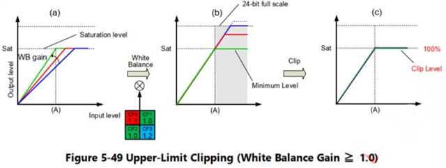

According to TDA4AL-Q1: IMX728_Halo issue - Processors forum - Processors - TI E2E support forums, we cowork with Sony sensor to do some test.
Sony's AWB algorithm has RGB clipping method to improve this halo issue. May I know if TI also has this kind of clipping method?
