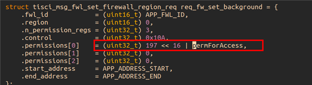

  • I setup a firewall on the BTCM memory.
    I setup region 0 as background region over all BTCM memory and enable every access.
    Then I setup region 1 as foreground region on the first 4Ko and disable every access.
    But when I write in the memory after setting the firewall, the core crash instead of reaching the error handler function.

        struct tisci_msg_fwl_change_owner_info_req req = {
          .fwl_id      = (uint16_t) APP_FWL_ID,
          .region      = (uint16_t) 0,
          .owner_index = (uint8_t) APP_R5F_HOST_ID
        struct tisci_msg_fwl_set_firewall_region_req req_fw_set_background = {
            .n_permission_regs = (uint32_t) 3,
            .control           = (uint32_t) 0x10A,
            .permissions[0]    = (uint32_t) 197 << 16 | permForAccess,
            .permissions[1]    = (uint32_t) 0,
            .permissions[2]    = (uint32_t) 0,
            .start_address     = APP_ADDRESS_START,
            .end_address       = APP_ADDRESS_END

  • Hi Charles,
    It doesn't seem to be the case in the background region, you are blocking access for every one.
    197 is PRIV ID for block everyone.PRIV ID for allowing everyone is 195.

  • Hi ,
    I changed the priv ID of the background region from 197 to 195
    The firwall has 4 regions. Is it possible to set 1 background region that would include every memory (ATCM, BTCM, ICACHE, and DCACHE), then which value for start and end addrress ?
    Because if I set 1 background region for each memory individually, there won't be any region left to setup foreground region for filtering
    Charles
  • Hi Charls,
    Yes that is possible, set address range in the background region like this 0x00000000 - 0xFFFFFFFFFF.
    Diwakar
  • Hi Diwakar Dhyani,
    I have setup the background region 0x00000000 - 0xFFFFFFFFFF
    and then forbid access to BTCM memory from every one
    When I try to access the memory from R5F and C7X, the core crash. Is it the normal behavior ?
    Charles
  • Hi Charles,
    This behaviour is normal. Since we've configured the firewall to block all access to that memory region, any attempt by the R5F or C7X processors to access it will intentionally generate a bus error.
    Diwakar
