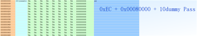

Hi:
My SDK version is 10.01.10.04.
I try to support a spi nor flash ds25m4cb  on my board and I add the driver.

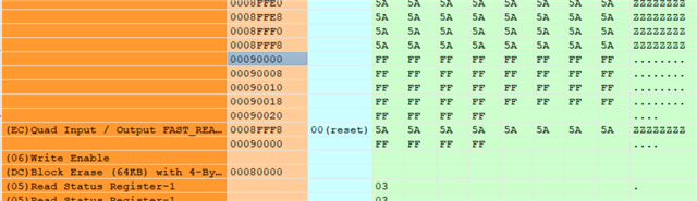

When I test read, I use logic analyzer to get signal. For every block 0x10000, I can get more 36 bytes , 72 clk(freq is 20M).
The address mode is 4 bytes address.The read command is 0xEC.
We checked dma, it sends 0x10000 bytes to driver and drops the 36 bytes. But for next block,  when I read it, the offset will add 36, so I will lose the 36 bytes data.
Why does it send the more 36 bytes data?

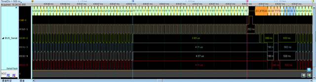

  • Hi Yong:
    flash_driver.zip
    Linux SDK.
    we use flash_torture to test. flash_torture -c 56 -r /dev/mtd1
    As show in pictures,  we read 0x10000.  range is 0x80000-0x8FFFF.
    When finish read, it still get 36 bytes.

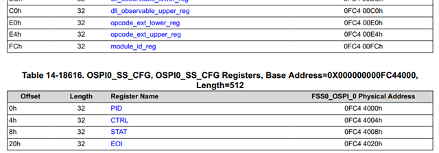

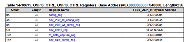

  • Dear Tom
    thanks for more detail.
    there is no similar issue on SK-AM62-LP which equipped an OSPI flash.
    please help check in below ways.
    1. capture the wave on CS/CLK/D0/D1/... to do the comparison.
    2. please help dump OSPI0 controller register on your board and also SK-AM62-LP EVM for comparison.
    TRM:
    thanks a lot!
    yong
  • Hi Tom,
    For testing purpose, can we set FSAS_SYSCONFIG[7]=DISXIP to "1" before running your flash read test?
    Note FSAS_SYSCONFIG register addr is 0x0FC10004
    -Hong
  • Hi Tom,
    From the quick test by running "flash_torture..." on target board during our debug call, the issue was not observed after setting DISXIP to "1".
    Let's run more test, and keep us updated with the test result.
    You'll find more details on FSAS_SYSCONFIG[7]=DISXIP in <14.8.4.2.2.1 FSAS_SYSCONFIG Register> in AM62x TRM.
    -Hong
