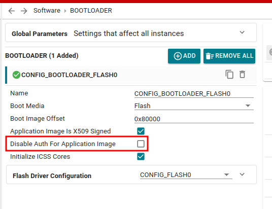

  • Hi Kiyomasa,
    Could you check if Disable Auth for Application Image options is enabled in your SBL OSPI's sysconfig:
    Meet.
  • Hello Meet Thakar
    Thank you for your reply.
    I unchecked the "Disable Auth For Application Image" checkbox and created the SBL OSPI again.
    However, an error occurs in
    Bootloader_verifyMulticoreImage
    Bootloader_socAuthImage(certLoadAddr).
    Upon further investigation,
    in the Sciclient_procBootAuthAndStart function,
    the return value of the Sciclient_service function is 0,
    but because respParam.flags is 0, retVal is SystemP_FAILURE.
    Do I need to configure something on the user application side as well?
    Changing the build options for the user application to authtype=0,1,2 did not improve the situation.
    The problem is still not solved.
    Kiyomasa Imaizumi.

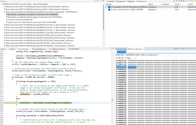

  • I will add more information.
    This may be related, but I'll answer a question from Prashant Shivhare from a previous post:
    e2e.ti.com/.../5131217
    I checked the memory at 0x60080000 using CCS just before Bootloader_socAuthImage.
    The area around 0x60080000 is 0xFFFFFFFF.
    Best regard,
    Kiyomasa Imaizumi.

  • Hello Meet Thakar.
    Let me explain the current problem.
    Originally, the user application would launch even if the flash area for the user application had been tampered with.
    I wanted to know if there was a way to use SBL OSPI to determine if the user application had been tampered with and prevent the user application from launching.
    So I checked the SBL and found that "Disable Auth For Application Image" was checked.
    I realized that this was why the SBL was not checking for tampering with the user application.
    So I unchecked "Disable Auth For Application Image" and
    wrote a new SBL and user application to the board.
    However, the user application no longer launched, even though it had not been tampered with.
    Currently, the problems I want to solve are as follows:
    - After unchecking Disable Auth For Application Image, the correct user application no longer launched.
    Kiyomasa Imaizumi.
  • I checked the memory at 0x60080000 using CCS just before Bootloader_socAuthImage.
    This is where your appimage is supposed to be, so ideally if you have flashed the image at this address, this shouldn't be possible.
    Have you flashed your application at am offset other than 0x80000, please also share the flashing logs.

    When SBL OSPI works on the custom board,
    Bootloader_parseMultiCoreAppImage returns -1,
    and the message "Some test have failed!" appears.
    Kiyomasa Imaizumi.

    "Build Board Configuration Obj Files"
    process_begin: CreateProcess(NULL, C:/ti/ccs2020/ccs/utils/cygwin/mkdir -p c:/ti/mcu_plus_sdk_am64x_11_01_00_17/tools/sysfw/boardcfg/obj, ...) failed.
    make (e=2): 指定されたファイルが見つかりません。
    makefile:199: recipe for target 'c:/ti/mcu_plus_sdk_am64x_11_01_00_17/tools/sysfw/boardcfg/obj/sciclient_defaultBoardcfg_security_hex.o' failed
    gmake: *** [c:/ti/mcu_plus_sdk_am64x_11_01_00_17/tools/sysfw/boardcfg/obj/sciclient_defaultBoardcfg_security_hex.o] Error 2
    c:\ti\mcu_plus_sdk_am64x_11_01_00_17>
  • but sciclient_defaultBoardcfg.c is not available in SDK 11.1.
    It's available in 11.1 as well.
    When I try to build it, I get the following error:
    For SDK version 11.1, CCS version recommended is 20.2, Please use the same version to avoid this error.
    Also, is it okay for only SBL OSPI to use the latest SDK (11.1)?
    User applications must use the older SDK version (mcu_plus_sdk_am64x_08_06_00_45).
    We usually recommend to use the latest SDK versions as it will have the latest bug fixes, first I want to check if using the latest SDK resolves this issue or not, so for testing this should be fine for now.
    Meet.
