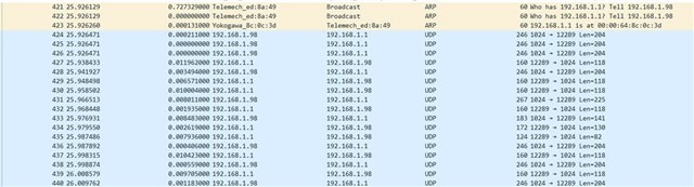

AM3352: After unplugging the network cable for one minute and then plugging it back in, the communication message appeared to be confused
Part Number: AM3352
Hi:
1) When our device communicates with a PLC through a network port, there is no problem with normal communication. However, if the network cable is unplugged or the PLC is powered off, and we wait for about a minute to restore it, the communication packet between the device and the PLC will be disrupted;
2) There are two messages in the attachment, one is the message that other products and this PLC can recover normally (GP4000), and the other is the message that our product and this PLC cannot recover normally after communication is restored. (192.168.1.1 corresponds to the address of the PLC, and the upper layer application processing of the two products uses the same WindRiver vxworks system, only the lower layer CPU is different)
3) From the confused messages, it can be seen that when reconnecting, the HMI sent three consecutive messages to the PLC with almost no time interval, and the subsequent PLC replies were confused.
I would like to know if there are any relevant configurations for the network port driver to not send cached messages when the link is disconnected in response to this situation,I have attached the code file for our current network port driver in the attachment.

  • Hi:
    It is not allowed to add pcapng files, so I capture the picture,please check

    4. I see that the communication between the PLC and the DUT is still intact, but the responses are missing for failed case. Is this the same observation from your side as well? Please provide more details seen in failure case

    4)From the message, it can be seen that when restoring communication, each subsequent reply is the reply content of the first three messages sent in sequence, rather than no reply, which causes packet confusion,The phenomenon is particularly similar to when there is a message in the port cache, and after reconnecting, the cached message is sent out, which is why this problem occurs.

    I have gone through the pcap captures. I couldn't make complete deductions on the responses, but the sequence looks slightly different from the normal case vs error case. In error case, when the ARP exchange is done, we are observing a burst of 3 packets with different content. Since the DUT is transmitting other packets earlier (for ARP), it is unlikely that the hardware is buffering the packets during transmission.
    This is looking more like a corner case in the application, where the link-down and link-up events are handled. After the initial burst, the subsequent exchanges are happening in concurrent different sequences, rather than single stream line the normal case. Can you please check if the customer application is handling the sequence of linkdown in a correct way? Are packets being enqueued in the buffer queues properly in the driver? Can you please provide more context on understanding the data?

    We have found that the value of INET_MAX_PKTS_PENDING in the  configuration is 3, which may cause packet capture. We are currently changing this value to 1 for verification and waiting for the verification result. If the result is normal, it should not be related to the CPU driver. If the result is abnormal, we need to continue further investigation.
    I will inform you once the verification results are finished.
    thanks
  • Hi :
    we just test the modification of changing the value of  INET_MAX_PKTS_PENDING from 3 to 1,that is the route cause,
    after modify,this issue can be resoloved,thanks for your support,
