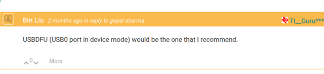

  • Hi Gopal,
    Yes, ROM only supports DFU on USB0, not on USB1 interface.
