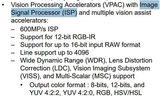

ISP function operate on the AM67?
Are you asking about AM67A? ISP function is not available in AM67x only in AM67A.
-Daolin
I'm inquiring about the AM67.
The datasheet mentions ISP, but is it not usable?

Hi Ito,
Looks like the datasheet is shared between AM67 and AM67A. You will have a better time finding specific information on the differences between AM67 and AM67A in the Product Details section of each device's product page (see below).
AM67: https://www.ti.com/product/AM67
AM67A: https://www.ti.com/product/AM67A
AM67 does not have ISP support but AM67A does.
