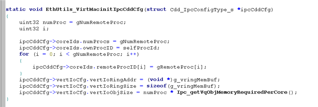

The Ethernet IPC buffer is initialized at runtime, but some of its structure parameters are retaining their default values from the build-time initialization instead of being fully updated with the new, intended data.

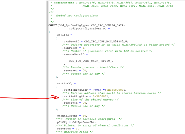

MCAL Gen code:
"VirtIoObjectSize" isn't being generated in the code, even though it was configured in the MCAL tool.
TI Code runtime initialization:
Kindly assist us. We need to set default values for parameters during the build-time MCAL generation process.
