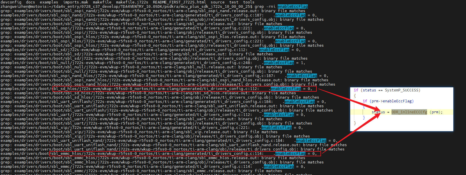

Hi expert,
Could you please help check how to enable DDR ECC? From below info, can we conclude the DDR ECC is not enabled? Thanks

Hi Xingyu Zhu,
Please look through the following documentation: https://software-dl.ti.com/jacinto7/esd/processor-sdk-linux-j722s/11_00_00_08/exports/docs/linux/Foundational_Components/U-Boot/UG-DDRSS-J7.html
