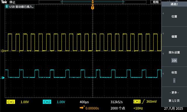

Our board has two phy DP83867IR mounted on the MDIO interface.
At present, during the cold start test of the board, there is a situation where the mdio bus registration fails, as shown in the figure below. When the problem occurs, the clocks of MDIO and MDC are always in the following state, indicating that the MDIO level is obviously incorrect:
It will print the following kernel log when the issue occur.
[ 1.341594] davinci_mdio 8000f00.mdio: davinci mdio revision 17.7, bus freq 1000000
[ 1.445718] davinci_mdio 8000f00.mdio: timed out waiting for user access
[ 1.552758] davinci_mdio 8000f00.mdio: timed out waiting for idle
[ 1.558865] davinci_mdio 8000f00.mdio: probe with driver davinci_mdio failed with error -5
    Can you confirm if the interface works some time and does not work some times or does not work any time?
    Can you describe the waveform?
    Do you have any capacitor load connected on the signals.
    Sreenivasa
  • It can be confirmed that the address is unique because it occasionally does not work, but most of the time it works normally。
    The above image shows the waveforms measured on MDC (yellow) and MDIO (blue) when a problem occurred.
    There is no capacitor load connected to the signal.

  • 1、power cycle:
    We use a switch power supply to power the board, and the network port of the board is connected to a gigabit switch through a network cable. After the system is started, a detection script will be launched to check whether the network port can negotiate 1Gbps. If the detection is successful, the switch power supply will be powered off for 5 seconds and then powered on again for the next cycle. If the detection fails, a failure signal will be fed back to the switch power supply to stop cutting off power.

    Based on a quick check i do not find any obvious issue.
    To isolate the issues below are the 2 suggestions
    The MDIO from the SOC is going to EPHY1 and WPHY2 through separate series resistors
    Would you be able to isolate one of the EPHY and test on only 1 EPHY
    Can you add a series resistor 500R instead of 0R and test. When you see the issue please measure the signals on both sides of the resistor.
    Can you change the ETH1 PHY address from 0 to another address. EPHY2 had 0001 address.
    Can you please confirm the switching frequency.
    The recommendation is to ensure all the SOC voltages decay to below 300mV before the next power cycle starts.

  • Thank you for your attention. Our current situation is as follows:
    I found a board that is easy to reproduce the problem, and this board can reproduce the problem within 100 cycles. The PHY ADDR of this board was changed from 0 to 2, and only reproduced twice. After that, this board was never reproduced again (approximately 7500 cycles did not reproduce).
    I changed the PHY ADDR of this board from 2 to 0 again, and the probability of reproduction decreased after long-term testing (previously it could be reproduced within 100 cycles).
    From the current test results, changing PHY-ADDR from 0 to 2 does not solve this problem.
    We have now added a hardware reset for phy in the driver and are currently undergoing long-term testing.
