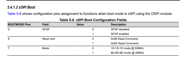

  • Hi Ryan,
    Could there be any known risk in XSPI mode that might lead to unintended writes to the flash status register?
    When ROM boots in xSPI bootmode, it does not performs any write operation, all it does is read, so from ROM boot perspective the bit you are talking about cannot be written to.
    Now coming to the bootmode which you are using, please let me know the bootmode pin configuration which you have.
    I need to get the values of the following bootmode pins:
    Moreover, share the flash datasheet as well.
    Looking forward to your response.
