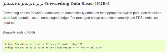

We use CPSW9G in native ethernet switch mode.
When editing FDB entries, as described by the TI documentation, there are no entries added to the ALE (as can be observed with "ethtool -d <port>")
3.2.2.10.3.2.3.1. CPSWng Native Ethernet — Processor SDK Linux for TDA4VM Documentation
Is this expected behavior in SDK11? Is there a possibility to edit ALE from A72? Is there current documentation on this?
I could only find older documentation like [FAQ] TDA4VM: How to Configure CPSW 5G/9G ALE - Processors forum - Processors - TI E2E support forums
