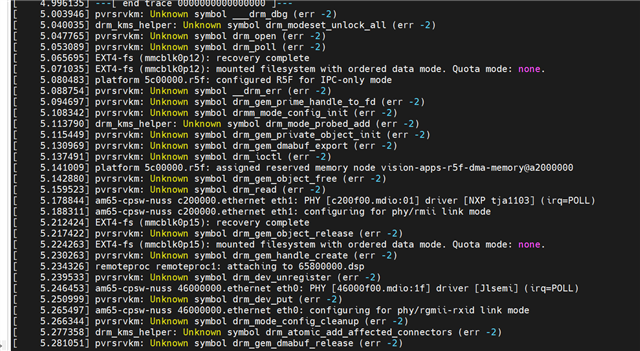

I tried to add the trace configuration of the linux kernel in Veco's 9.2SDK as follows

I used your trace-related configuration, but there is still a DRM error, and I can't run some of my applications.

2. There is not only DRM in the error report, but also other modules, and it is useless to disable DRM alone. And it actually affects the activation of the R core

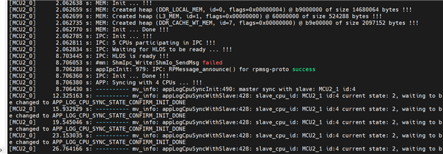

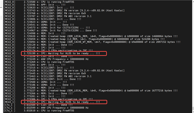

I tried to edit the whole package and then update the whole package, and the kernel would not report the error of the unsigned table, but the r5f and c7x was still abnormal.Blocking in the function appLogCpuSyncWithSlave
