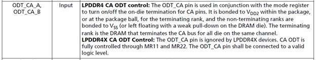

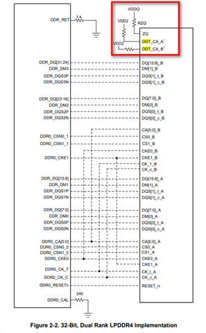

From below guide, I can see the resistor value for others, but there is missing the value of ODT_CA_A/B, do we have any recommend value? In EVM, we are using 10K, but I want to double check about this, is it the best value? because from the Sitara AM62P board, we use 2.2K, and some customer is using 1K, so I want to figure it out, what is the best value? can you share some standard (Memory datasheet or JEDC?) customer need to follow, or any pull up resistor value can be accepted?

  • The specific resistor value is not critical - as its not a calibration or termination resistor value.  It is a logic input - so any resistor value can be used as long as it sets the correct logic value. All the resistor values you mentioned (10K, 2.2K, 1K) should all be fine.

    So if this signal is connected to 1.1v, the pull up resistor value is not matter, right? but previously in TDA4VEN EVM, customer connect to 0.55v(pull up to 1.1v with 10K and pull down with 10K), the DDR will have some stability issue (can work in low frequency, but failed in high frequency), and Micron lpddr4 can work in all frequecy, but Samsung and other ddr vendor can't work. this is interesting result if this is just logic input. capture from the micron ddr datasheet, can it be applied to all DDR vendor?

  • The signal is an input and the responsibility of the board design is to provide the proper logic high or logic low value.  The mentioned 0.55V was an error because that is an invalid logic level.  That voltage resulted from an on-board pull-up and on-board pull-down....which is a manufacturing mistake and not a valid implementation.  There should be no pull-down resistor on board.
    The 'weak' internal pull-down resistor and/or leakage current into the input pin may vary across memory manufacturers - so I recommended customer references those datasheets.  (For example - in datasheet I am reviewing, I see no definition of weak internal pull-down, but I do see max input leakage of 4uA).  In general - resistors in range of 1K to 10K should have no issue setting proper logic level for this pin.

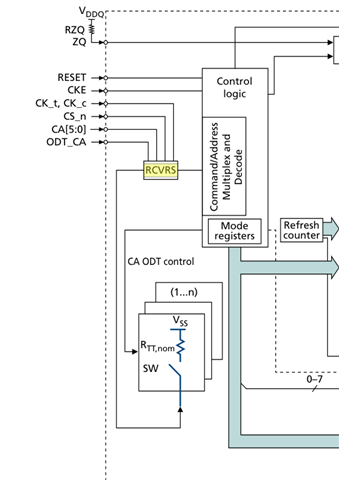

    due to the weak pull down, may be smaller pull up resistor will be better, right? but I can't make it clear only from the LPDDR4 datasheet, form below bloack diagram, the internal pull down may not have any impact to the ODT_CA because of the RCVRS (not sure what it is). I will let customer try smaller pull up value to have a try first. Thanks a lot for your support.
