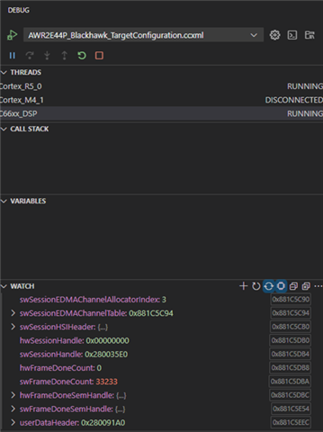

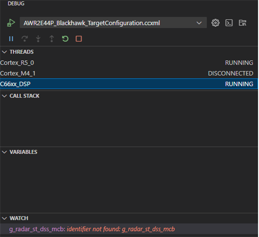

When customer used CCS v20.2.0 with AWR2E44P. He cannot check real-time variables during debugging.
While debugging, when selecting a core in the RUNNING state, if the variable shown in the WATCH window belongs to that core, in CCS v12.x.x the variable’s value was updated in real time (especially for the DSP, the variable values were periodically refreshed).
However, in CCS v20.2.0, the variables are not updated and instead appear as unrecognized errors.
If I pause and then resume the selected core, the variable values are refreshed. Could you let me know whether this issue is a bug, or if there is a separate setting that needs to be enabled?
• Picture 1: When selecting the DSP core in RUNNING state, the variable is not recognized.
• Picture 2: After pausing, the variables are refreshed. (However, if I then switch from R5_0 core back to the DSP core, the variables again stop updating.)

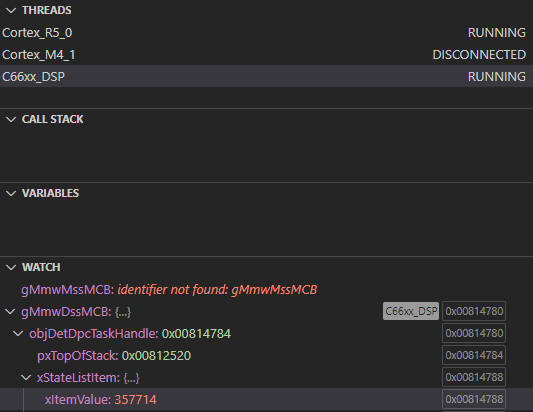

  • Thank you. Can you provide a similar screenshot of things working in CCS 12 with the same target, debug probe, and application?
  • Hello Ki,
    I'm giving you this screenshot. If you need anything else, please let me know.
    Seung.
  • Thank you. I can see the DSP running and loops like variables can be accessed in CCS 12
  • I tried a target more closely related - AWR2944 EVM. Again there was no issue with real-time memory access with CCS 20.2.0 on the DSP.

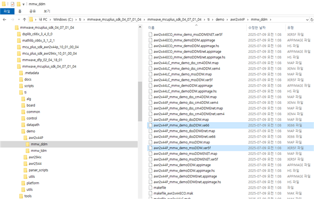

  • Hello Ki,
    Sorry for the delayed response.
    I ran the mmw_ddm demo application and observed the same result.
    If you have time, could you try running the same test on your side and share your findings?
    Seung.

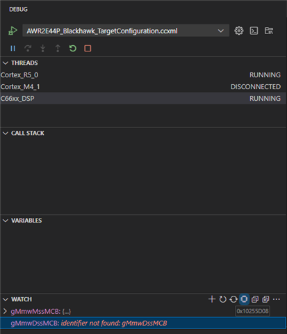

  • If you have time, could you try running the same test on your side and share your findings?
    I tried this example at it worked for me.
    Based on your screenshot, I believe you are running into this known issue:
    https://sir.ext.ti.com/jira/browse/EXT_EP-12938
    Can you explicitly pin the variable to the debug context as a workaround? See my video below:
  • Hello Ki,
    I applied the workaround and was able to inspect the variable successfully.
    I hope the bug will be resolved soon.
    Thank you.
  • I applied the workaround and was able to inspect the variable successfully.
    Great!
    Please continue to use the workaround with CCS 20.3.0.
