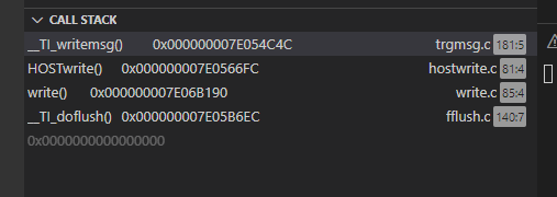

  • Actually I already tried replace OSPI_readDirect with OSPI_readIndirect, but when replaced, the thread died.
    My code
    static int32_t Fla_norOspiRead(Flash_Config *config, uint32_t offset, uint8_t *buf, uint32_t len)
        int32_t status = SystemP_SUCCESS;
        Flash_NorOspiObject *obj = (Flash_NorOspiObject *)(config->object);
        Flash_Attrs *attrs = config->attrs;
        if (obj->phyEnable)
            OSPI_enablePhy(obj->ospiHandle);
        /* Validate address input */
        if ((offset + len) > (attrs->flashSize))
            status = SystemP_FAILURE;
        if (status == SystemP_SUCCESS)
            OSPI_Transaction transaction;
            OSPI_Transaction_init(&transaction);
            transaction.addrOffset = offset;
            transaction.buf = (void *)buf;
            transaction.count = len;
            transaction.dmaCopyLowerLimit = OSPI_NOR_DMA_COPY_LOWER_LIMIT;
            status = OSPI_readIndirect(obj->ospiHandle, &transaction);
        if (obj->phyEnable)
            OSPI_disablePhy(obj->ospiHandle);
        return status;
    And I use JTAG, the callstack is

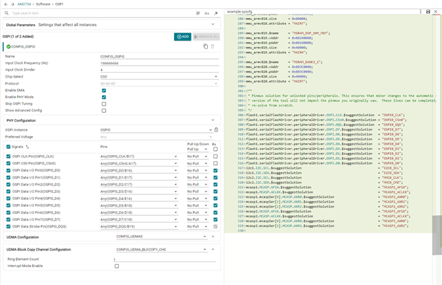

    For INDAC reads, I would suggest you to disable Phy mode and DMA and check if it works for you. It should work with this combination where DMA and PHY is disabled.
    Vaibhav
