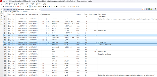

on C66, CCS 10, I'm tracing a simple function that do some checks and when these checks are positive invoke a function derived from an address parameter, I see the instruction
BNOP.S2 B3,4
Taking 4 cycles (row 9, column Delta cycles) as expected
but then the same address is showed again with 8+1 delta cycles.

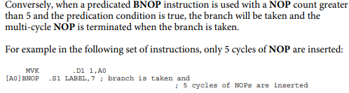

This is not expected, as reported on sprugh7:
Why are these extra cycles reported? Are just a tool artifact?
The trace option is "Custom Core Trace", with Trigger1 "Start trace" at "Point", Trigger2 "Stop trace" at Point.
Thanks for the attention

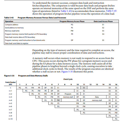

    I believe this is a symptom from the Pipeline stall, due to some hazard, "bubbles" or cycles are inserted delaying the entire pipeline including the BNOP, causing it to be processed for extra cycles as it waits its turn. then a second one is called again and can branch already and the BNOP is terminated in only one cycle.. example from same sprugh7:

  • Thanks, the problem is that if the stall is not accounted on the intended instruction it is hard to understand the situation.

    Some of your questions are answered in the document sprugh7, like for example:
    this part explains your initial question, or as I explained the bubbles, as it was taught to me from fundamental computer architecture.

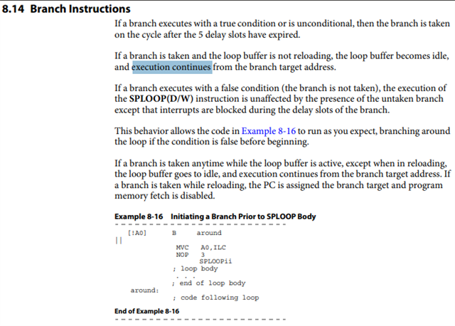

    My analysis is an inference from the  TMS320C66x DSP CPU and Instruction Set Reference Guide when referring to branch instructions, See Chapter 8.14
    Please read this document in its entirety for better clarity of C66 instructions and programming model.
