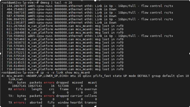

We used SK-AM62-LP for CAN communication verification (standard frame, 1Mbps). The verification method was to continuously send message using another board .
In the initial SDK9 version, both the main can and the MCU can would occasionally have overrun errors.
Later, following FAE's advice, I switched to the latest SDK11.01.05.03 (not RT-Linux), and the overrun error no longer occurs. However, if you plug or unplug the network cable or start our application at this time, the overrun error will still occur.
main can test:
mcu can test:
When changing RT-Linux, overrun will also appear when plugging or unplugging the network cable.
We analyzed that the cause of the overrun error is that the kernel failed to remove the data in the fifo of the CAN drive in time. Is that so? Is there any way to solve it?

         I verified with SK-AM62-LP, not reproduce this issue, SDK 11.1.5
        root@am62xx-lp-evm:~#
    root@am62xx-lp-evm:~# uname -a
    Linux am62xx-lp-evm 6.6.58-ti-01497-ga7758da17c28-dirty #1 SMP PREEMPT Wed Nov 27 13:23:15 UTC 2024 aarch64 GNU/Linux
    ip -s -s link show mcu_mcan0
    root@am62xx-lp-evm:~# ip -s -s link show mcu_mcan0
    5: mcu_mcan0: <NOARP,UP,LOWER_UP,ECHO> mtu 16 qdisc pfifo_fast state UP mode DEFAULT group default qlen 10
    link/can
    RX: bytes packets errors dropped missed mcast
    546417 94999 0 0 0 0
    RX errors: length crc frame fifo overrun
    0 0 0 0 0
    TX: bytes packets errors dropped carrier collsns
    12 509475 0 0 0 0
    TX errors: aborted fifo window heartbt transns
    0 0 0 0 1
    after unplug/plug CAN BUS, no CAN frame drop

    after unplug/plug Ethernet calbe, the error occured,
    root@am62xx-lp-evm:~# [ 2556.944600] am65-cpsw-nuss 8000000.ethernet eth0: Link is Down
    [ 2558.992644] am65-cpsw-nuss 8000000.ethernet eth0: Link is Up - 1Gbps/Full - flow control rx/tx
    [ 2559.001307] m_can_platform 4e08000.can mcu_mcan0: msg lost in rxf0
    [ 2559.007695] m_can_platform 4e08000.can mcu_mcan0: msg lost in rxf0
    [ 2559.014058] m_can_platform 4e08000.can mcu_mcan0: msg lost in rxf0
    [ 2559.020420] m_can_platform 4e08000.can mcu_mcan0: msg lost in rxf0
    [ 2559.026776] m_can_platform 4e08000.can mcu_mcan0: msg lost in rxf0
    [ 2559.033128] m_can_platform 4e08000.can mcu_mcan0: msg lost in rxf0
    [ 2559.039464] m_can_platform 4e08000.can mcu_mcan0: msg lost in rxf0
    [ 2559.045808] m_can_platform 4e08000.can mcu_mcan0: msg lost in rxf0
    [ 2559.052141] m_can_platform 4e08000.can mcu_mcan0: msg lost in rxf0
    [ 2559.058477] m_can_platform 4e08000.can mcu_mcan0: msg lost in rxf0
    [ 2559.064817] m_can_platform 4e08000.can mcu_mcan0: msg lost in rxf0
    [ 2559.071156] m_can_platform 4e08000.can mcu_mcan0: msg lost in rxf0
    [ 2559.077497] m_can_platform 4e08000.can mcu_mcan0: msg lost in rxf0

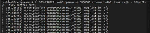

  • HI Spatton
        please help investigate this issue,
        when enable main_mcan0 for receive,
        same issue happened, even main_mcan0 is interrupt-mode,
    main_mcan0 7E7 [8] 79 0C 4A 30 59 31 17 5B
    main_mcan0 [ 504.345705] m_can_poll 1063, WORK 64, quota 64
    ^CF 43 30 FD C0 1E
    [ 504.355499] m_can_platform 20701000.can main_mcan0: msg lost in rxf0
    root@am62xx-lp-evm:~# [ 504.363715] m_can_poll 1063, WORK 64, quota 64
    [ 504.370015] m_can_platform 20701000.can main_mcan0: msg lost in rxf0
    [ 504.376520] m_can_poll 1063, WORK 64, quota 64
    [ 504.380981] m_can_platform 20701000.can main_mcan0: msg lost in rxf0
    [ 504.387483] m_can_poll 1063, WORK 64, quota 64
    [ 504.391945] m_can_platform 20701000.can main_mcan0: msg lost in rxf0
    [ 504.398455] m_can_poll 1063, WORK 64, quota 64
    [ 504.402920] m_can_platform 20701000.can main_mcan0: msg lost in rxf0
    [ 504.409422] m_can_poll 1063, WORK 64, quota 64
    [ 504.413885] m_can_platform 20701000.can main_mcan0: msg lost in rxf0
    [ 504.420394] m_can_poll 1063, WORK 64, quota 64
    [ 504.424862] m_can_platform 20701000.can main_mcan0: msg lost in rxf0
    [ 504.431364] m_can_poll 1063, WORK 64, quota 64
    [ 504.435829] m_can_platform 20701000.can main_mcan0: msg lost in rxf0
    [ 504.442324] m_can_poll 1063, WORK 64, quota 64
    [ 504.446807] m_can_platform 20701000.can main_mcan0: msg lost in rxf0
    [ 504.453306] m_can_poll 1063, WORK 64, quota 64
    [ 504.457773] m_can_platform 20701000.can main_mcan0: msg lost in rxf0
    [ 504.464274] m_can_poll 1063, WORK 64, quota 64
    [ 504.468742] m_can_platform 20701000.can main_mcan0: msg lost in rxf0
    the problem is that m_can can't receive the frame quickly,
    after stop TX, it will recover from error,
       Semon

    Hi Schuyler
        connect AM62 main_mcan0 (with CAN transceiver SN65HVD230) to J722S mcu_mcan0(other board is same too),
    send traffic from J722S with following command:
     cangen mcu_mcan0 -g 0 -p 10 -x
    then unplug/plug eth0 cable of sk-AM62x-lp, following log will be printed:
    if stop CAN traffic, AM62x can recover,
    follow the steps in the AM62X can test setup.
    4.1.7. How to enable MCAN in Linux — Processor SDK AM62x Documentation
       Semon
