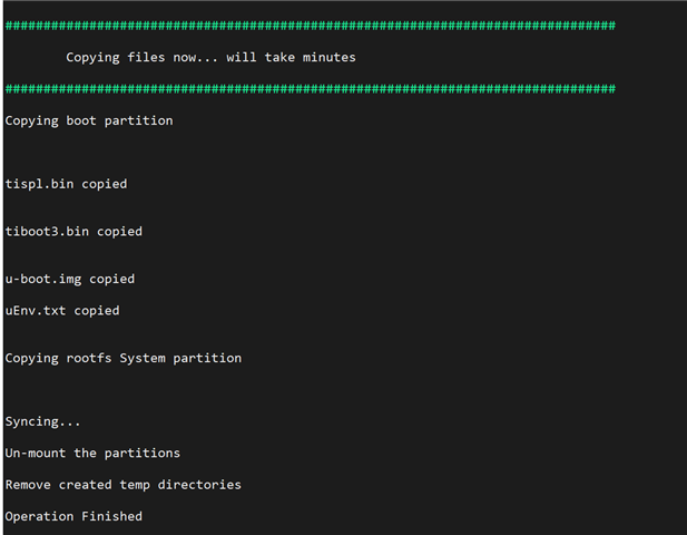

AM62L: AM62L SD card boot failed
Part Number: AM62L
I tried to boot from SD card, but it seemed not to be working properly.There is no output information on the serial port.
The boot image was created by using a script(create-sdcard.sh),and is configured as pre-build image from sdk
no erro info while creating boot image
The boot configuration switch is the same as the configuration in the quick guide.
  • Hi Chen,
    I did a quick test at my end, followed the same process, and I am able to boot using SD card on ti-processor-sdk-linux-am62lxx-evm-11.00.15.05, could you let me know which SDK version you have tested with and which serial terminal you used to check the boot logs.
