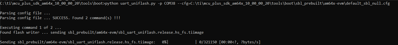

However, on the custom board, we are encountering an issue during the UART Uniflash flashing process using the SBL_prebuilt binary. The process fails at the initial step and does not proceed further.
Query:
a) Unable to flash "default_sbl_null.cfg" boot image?
Requesting your support on this. Please do revert with your inputs.

    I assume you are using a different OSPI Flash than the one used on the EVM, Please check this guide on adding support on custom flash device: https://software-dl.ti.com/mcu-plus-sdk/esd/AM64X/11_01_00_17/exports/docs/api_guide_am64x/CUSTOM_FLASH_SUPPORT_GUIDE.html
    Meet.

    Please note that default_sbl_null is to flash the SBL NULL to OSPI and not EMMC, are you now able to successfully flash to the OSPI at least after my suggestion in the previous response.

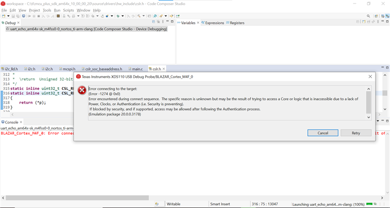

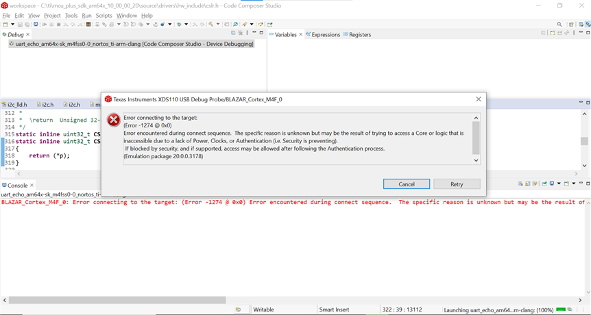

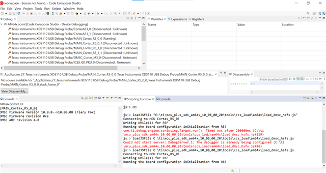

    Yes, we are currently unable to flash the image to the Cortex-M4F core using CCS IDE, regardless of the boot mode selected (UART, OSPI, or DEVBOOT), we had validated in Evaluation kit.
    Mag Observation:
    When connecting the JTAG (XDS110 via 20-pin connector) to the device, we encounter the following log output:
    Log observed while flashing the image in EMMC mode
    Log observed while flashing the image in xSPI mode /Uart mode/DevBoot mode.

  • This just indicates the SoC/M4 core is not initialized yet. There are several ways to initialize the SoC, please refer to this guide: https://software-dl.ti.com/mcu-plus-sdk/esd/AM64X/11_01_00_17/exports/docs/api_guide_am64x/EVM_SETUP_PAGE.html#EVM_SOC_INIT
    For flashing to EMMC you can use UART UNIFLASH with default_sbl_emmc_hs_fs.cfg: https://software-dl.ti.com/mcu-plus-sdk/esd/AM64X/11_01_00_17/exports/docs/api_guide_am64x/TOOLS_FLASH.html#autotoc_md3123
    You can try to use this once and check the result. Here SBL EMMC will initialize the SoC and then you can connect to CCS for debugging and you don't need to load the program from CCS then because SBL EMMC will handle it.

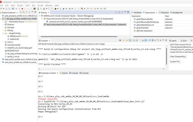

    We attempted SoC initialization using DEV BOOT mode and executed the loadJSfile command with the load_dmsc_hsfs.js script. While the scripting logs are visible, the logs in the "AM64X CIO" console, does not proceed or start as outlined in the script.
         Scripting Console logs, but nothing observed from CIO console.

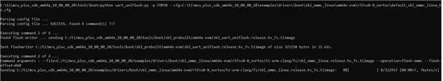

    As per your input, we used UART Uniflash with the default_sbl_emmc_hs_fs.cfg configuration file for flashing to eMMC:
    We followed the procedure for UART boot mode and flashed the sbl_emmc_hs_fs.cfg file and also our combined M4 binary. However, only the bootloader begins flashing; the actual image flashing does not initiate. Please find the relevant logs attached.
      Logs of SBL_EMMC image with no communication to EMMC.
    This seems strange, are you able to connect to a53 cores at least or is it just R5 for now? Please share the console GEL log as shown here: https://software-dl.ti.com/mcu-plus-sdk/esd/AM64X/11_01_00_17/exports/docs/api_guide_am64x/EVM_SETUP_PAGE.html#autotoc_md41
    Did you add custom flash configuration in UART UNIFLASH example and rebuild it before using it? If not you might face this issue.

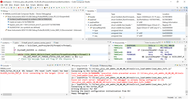

    The core images are flashed and booted from eMMC, and the A53 core successfully boots using DFU mode, the A53 core comes up as expected.
    We are able to detect and connect to the R5 core via JTAG, but only when operating in DEVBOOT mode. In other boot modes, we encounter a "Load program error", and flashing does not proceed.
    During SoC initialization, we executed the loadJSfile command using the load_dmsc_hsfs.js script.
    The process halts at the sciclient_load_firmware() function, which is called from System_Init().
    This indicates that the firmware loading is not completing successfully, preventing full SoC initialization.
    logs are attached below is observed during SOC intialization :
    Could you revert back what causes this issue and how do i proceed further for Cortex M4.

  • Hi Ganesh,
    The issue seems to be with the Sciclient_ccs_init.out binary. A similar issue has already been resolved in below thread.
    Please try to rebuilt the above binary and load it on R5F after connecting to the core via JTAG.
    Please refer  RE: AM6442: AM64 SoC Initialization Using CCS Scripting, does not work on EVM and custom board
    Tushar
  • Hi Tushar,
    This indeed was a  sciclient_ccs_init.release.out binary issue, now we are one step ahead with detection of M3 core with JTAG.

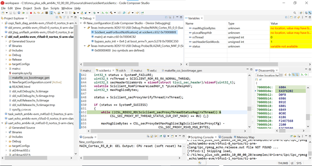

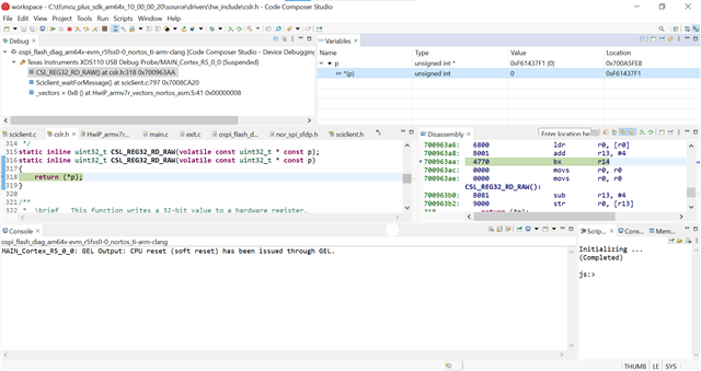

  • Hi Thakar & Tushar,
    With your guidance, I successfully loaded the OSPI diagnostic example and retrieved the configuration for our custom flash setup, which uses only 4 data lines connected to the processor.
    Based on the configuration output from the terminal, we updated the flash settings in the SBL_NULL project. After building and flashing the image, the flasher script appears to load correctly, but the image execution gets stuck.
    Upon debugging the project via JTAG, we observed that the execution halts at the Sciclient_waitBootNotification() function. Notably, the Sciclient release image enabled detection of the M4 core. Could there be a linkage or dependency in the Sciclient configuration that needs to be modified to support this setup?
    Please provide your inputs on this.

  • Hi Ganesh,
    Are you trying to load the SBL NULL program from CCS after it's already flashed it once? In that case you this is expected.
